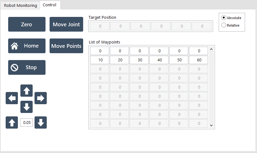

Next to the Monitoring tab is the Control tab as shown in the Figure.
Robot Control Area
  • Zero : Move to zero position (i.e. all joints' angles are zero).
  • Home : Move to Home position (i.e. Home is a pre-defined position).
  • Stop : Slow stop command Move Joint to the target position.
  • Target Position : The target is in degree and used by Move Joint function.
  • Move Points : Move the robot through a list of waypoints.
  • List of Waypoints : This is a 2D array of Nx6. N is the number of points and 6 is the number of robot's joints.
  • ←→↑↓ : Those buttons send commands to move robot's TCP along the X, Y, and Z axis with respect to the global coordinate. Moreover, the moving distance is declared in the numeric indicator between the ↑ and ↓ button.

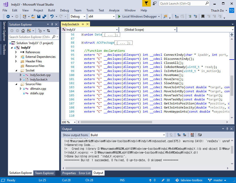

The IndyLV project, which is found in the Toolbox repository, looks like the Figure in Visual Studio. As a developer, you need to pay attention on the IndySocket.h and IndySocket.cpp only. Those files declare and implement APIs called by the Indy LabVIEW VI.
IndyLV Project in Visual Studio C++
By taking a closer look at IndySocket.h in the Code, you can see the declarations of all functions implemented for the shared library. Below list is brief description of each function. You are welcome to dig deeper into the source code for implementation of the functions.

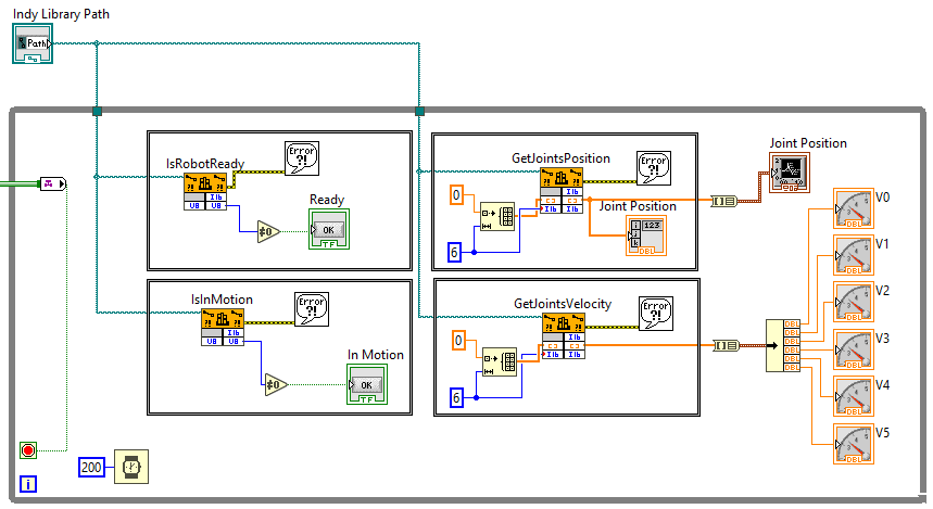

Now, let us take a closer look into the Robot Monitoring Block Diagram. There is one loop covering 4 library calls to IsRobotReady, IsInMotion, GetJointsPosition, and GetJointsVelocity. Then, the feedback data are visualized by appropriate UI component such as LED, Waveform Chart, and gauges.
Robot Monitoring Block Diagram objects

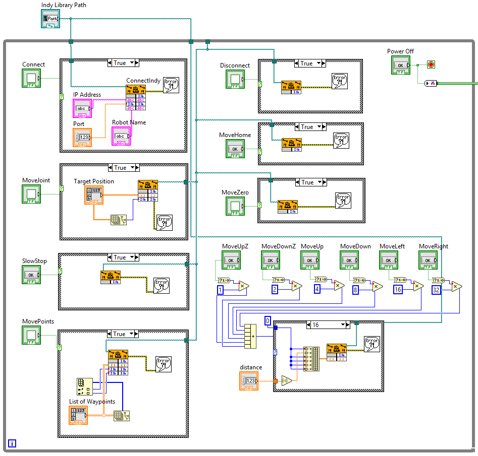

Meanwhile, the Robot Control Block Diagram in the Figure uses its loop to poll its UI components. This loop does not need a sleeping clock because it is inactive most of the time until a UI event happens. For instance, when you click MoveHome button, it changes state from False to True and consequently triggers the MoveHome function call in the Switch/Case object. This call sends a request to Indy Framework via TCP socket to move robot to Home position.
Last but not least, a Power button is a safe method to terminate the Monitoring and Control loop and close the Indy VI finally. In this case, you can use a Tag channel to transfer the Power button's signal to the loop's termination condition.
Robot Control Block Diagram objects
