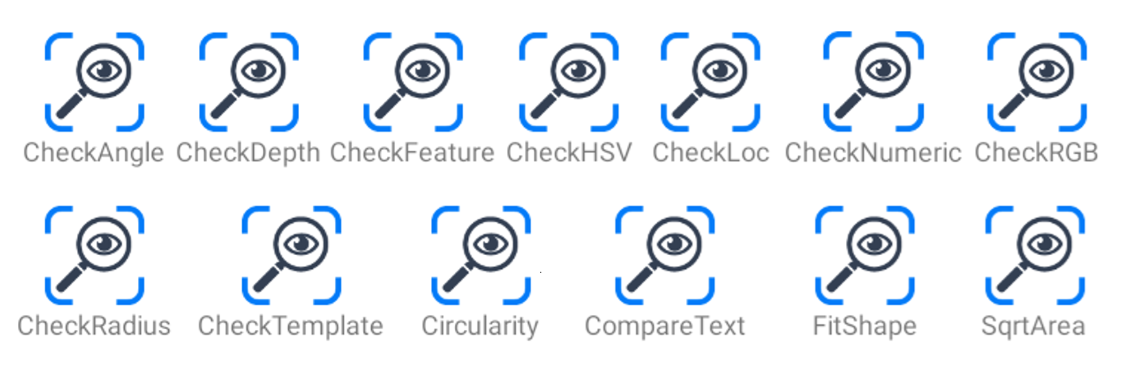

Inspection
  • CheckAngle : Checks the angle of the recognized object.
    • If the angle of the object is greater than or equal to ANGLE START and less than or equal to ANGLE END, it is processed as PASS.
      Example: (ANGLE START) 30 <= (object angle value) <= (ANGLE END) 50
    • If ANGLE START is greater than ANGLE END, it is processed as PASS if the object angle value is greater than or equal to ANGLE START or less than or equal to ANGLE END.
      Example: (ANGLE START) 350 <= (object angle value) or (object angle value) <= (ANGLE END) 10
    • ANGLE START : The start value of the angle to check.
    • ANGLE END : The end value of the angle to check.
  • CheckDepth : Check depth of currently detected object. (only for 3D)
    • If the depth of currently masked area is in RANGE around this value, it is marked as "pass.
    • DEPTH : The reference value of depth
    • RANGE : The allowed tolerance.
  • CheckFeature : Inspect object with key features.
    • BEST MATCH COUNT : The number of feature points to be used for a detecting single object. The smaller the value is, the easier it is to detect, with a loss of accuracy.
    • DETECT NUM : Maximum number of detections.
    • ERROR CUT : Maximum level of error to be considered as a valid detection. With a greater error-cut, you can detect more objects, with a loss of accuracy.
    • MATCH THRESH : The maximum difference to be considered the same feature points. With greater match-thresh, you can find more feature point matches with less accuracy.
    • TEMPLATE : The image of target object to be detected. Template should be saved in advance.
  • CheckHSV : Check if the currently detected region for certain hue, saturation, Brightness values
    • HUE, SATURATION, VALUE : The reference HSV values
      • HUE : Color indication value ranging 0~360. The spectrum is in the order red-yellow-blue-purple.
      • SATURATION : Saturation value ranging from 0~100.
      • VALUE : Brightness value ranging from 0~100.
    • MODE : Method for checking the region, take the average values of the area or check the center point.
    • RANGE H, S, V : Allowed tolerance of HSV values (If it is within the range above or below the reference color value, it is displayed as normal.)
    • TOUCH : Touch the screen to set the HSV reference values to the values of the touched area
  • CheckLoc : Inspect the pixel location of detected region.
    • X MIN, X MAX : The minimum and maximum values of X axis value.
    • Y MIN, Y MAX : The minimum and maximum values of Y axis value.
  • CheckNumeric : Compares a numeric value to a reference value.
    • VARIABLE : Variable name of the value to compare to
    • REF VALUE : Reference value
    • TOLERANCE : Tolerance
  • CheckRGB : Check the currently detected region for a color
    • BLUE, GREEN, RED : Color in RGB values
    • RANGE B, G, R : Allowed tolerance of HSV values (If it is within the range above or below the reference color value, it is displayed as normal.)
  • CheckRadius : Inspect radius of detected area.
    • INLIER RATIO : The minimum inlier ratio to pass the inspection.
    • ITER COUNT : The number of iteration in RANSAC algorithm.
    • R MIN, R MAX : The minimum and maximum radius.
    • SAMPLE NUM : The number of points to sample from the edge contour.
    • TOLERANCE : The maximum error for the inliers.
  • CheckTemplate : The most basic template matching method for inspection. It assumes the size and orientation of the object is not different from the template.
    • CONCORDANCE CUT : Minimum concordance rate to be detected.
    • REF SIZE : The template is resized into REF SIZE. The smaller the size is, the faster the calculation is, but less accurate.
  • Circularity : Check the circularity of the detected area
    • CUT : If the roundness is higher than the set value, it is displayed as normal.
  • CompareText : Compare and check text detected by OCR, ScanCode, etc.
    • REGISTER : Save the currently detected text
    • CUSTOM REGISTER : You can write a custom text that is not recognized by IndyEye. You must click the REGISTER button to register it in the list of comparison criteria texts.
    • METHOD : Comparison method, equals (==), does not equal (! =), equal or bigger (> =), equal or less than (<=), greater than (>), less than (<)
    • VALUE : Reference for comparison, selectable from saved text
    • VALUE CONVERSION : Value conversion format. If set, the recognized text and comparison criteria text are converted to the set format and then compared.
  • FitShape : Check if detected area fits a specific shape
    • ASPECT CUT : Upper limit of aspect ratio if it is not a circle or square
    • BURR LIMIT : Upper limit of pixels deviating from the reference shape
    • SHAPE : Reference shape
      • ellipse
      • triangle
      • tetragon
      • pentagon
      • hexagon
      • heptagon
      • octagon
  • SqrtArea : Check the area of the detected area. The square root of the area is used as criterion. If the detected area falls within the range within the range based on the REF SIZE, it is determined as normal.
    • RECORD : Record the square root of the current mask width
    • REF SIZE : The reference value of square root area.
