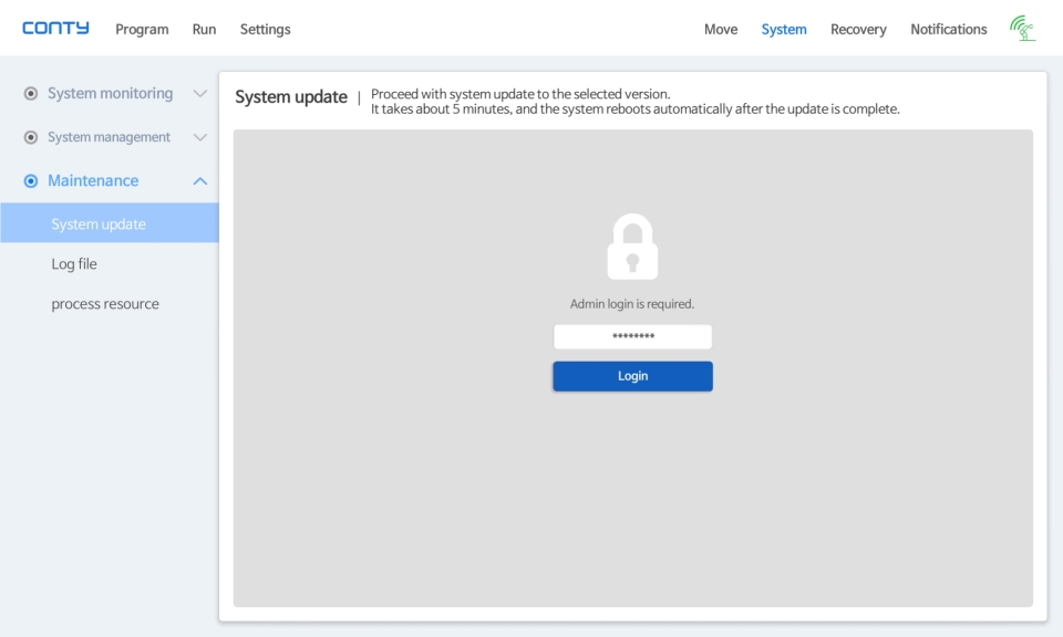

If you have already installed Conty version 3.4+, software updates can be performed using Conty. After connecting to the robot through Conty, click on the 'System' tab located at the top and then click on Maintenance - System Update on the bottom left, a login screen will appear as shown below.
Enter Password

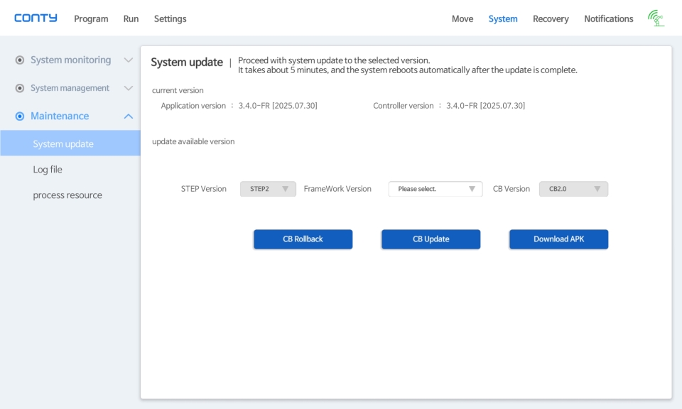

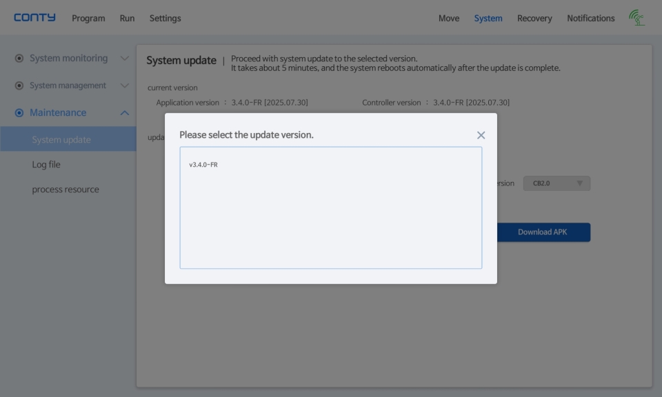

After entering the admin password and pressing the Login button, the system update screen will appear. In the center, press the FrameWork Version button and select the version you want to update.
System Update
Select Version Popup
