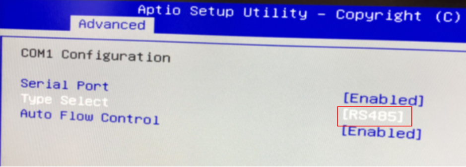

Then, go to BIOS settings and change COM1 type to RS485:
  • From BIOS screen, navigate to Advanced > Super IO Configuration > COM1 Configuration
  • Select COM1 port type [RS485]
Change COM1 type to RS485
