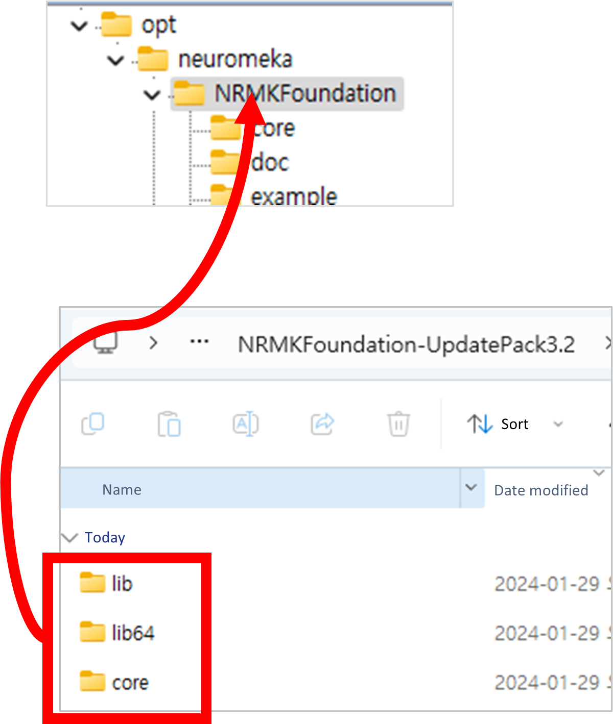

4. Update NRMKFoundation Folder:
  • In the /opt/neuromeka/NRMKFoundation folder, place the files obtained from extracting NRMKFoundation-UpdatePack3.2 downloaded from the previous step. Overwrite the existing files.

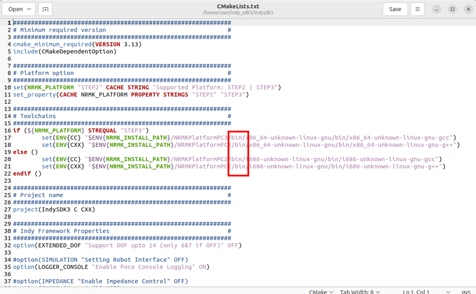

    4. Modify Directory Names
    a. Open the CMakeLists.txt file for editing:
    sudo gedit CMakeLists.txt
    b. Update lines 17, 18, 20, and 21 by changing occurrences of Drivers to bin in the environment variable locations.
    Changing "Drivers" to "bin"

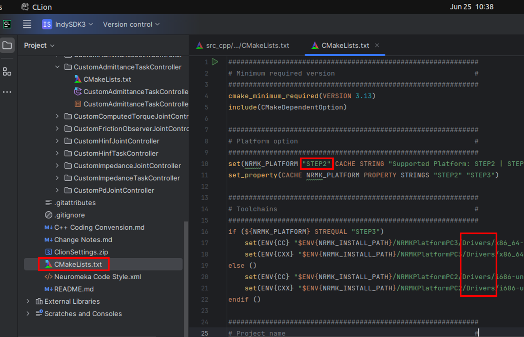

    5. Modify CMake Configuration
    a. Open the CMakeLists.txt file.
    b. Set NRMK_PLATFORM to match the STEP used (STEP2 or STEP3).
    c. Update occurrences of Drivers to bin in lines 17, 18, 20, and 21 in the environment variable locations.
    d. Save the changes.

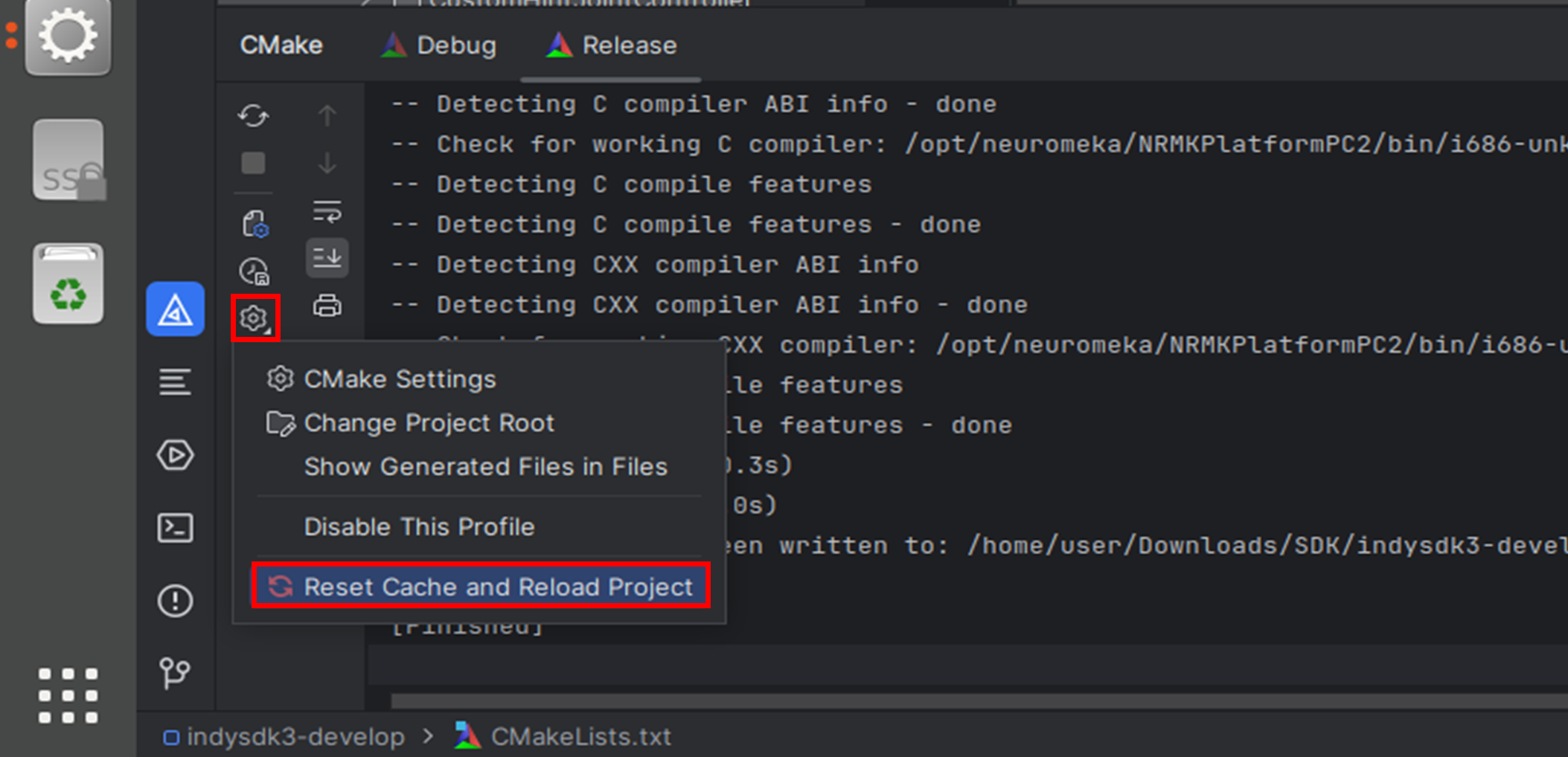

    6. Reset Cache and Reload Project
    a. After completing the CMake setup, click the Gear icon.
    b. Select Reset Cache and Reload Project.

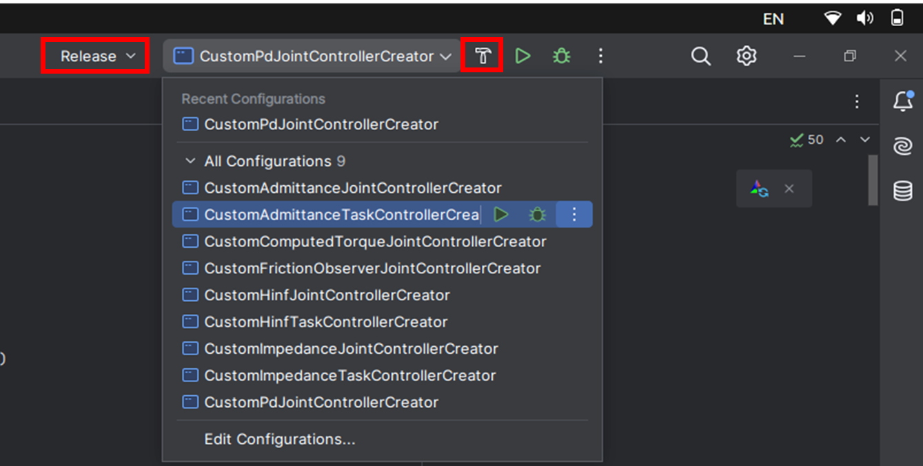

    7. Build the Project
    Build the Project
    a. Select the Controller you want to build in the drop down.
    b. Click the Hammer button to start the build.

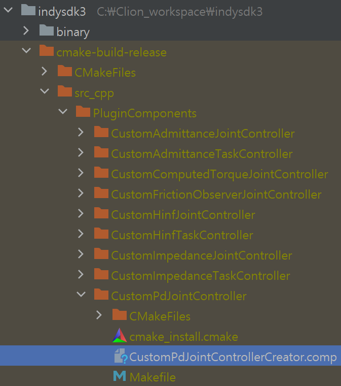

    8. Verify Build Completion
    a. When the build is complete, the built file will be saved in the cmake-build-release/src_cpp/PluginComponents folder.
