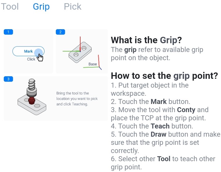

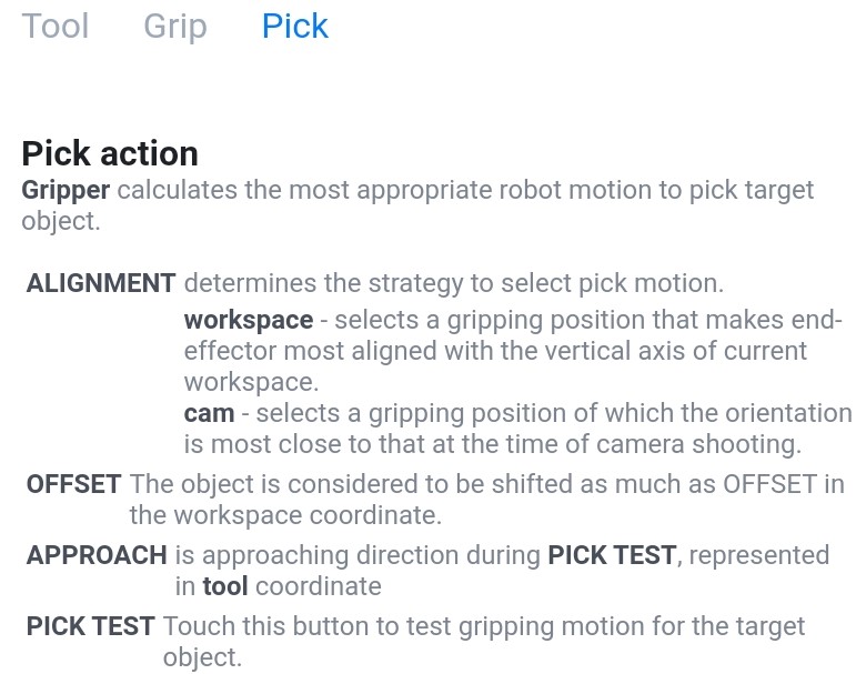

- Gripper : Teach grasping action for objects.
