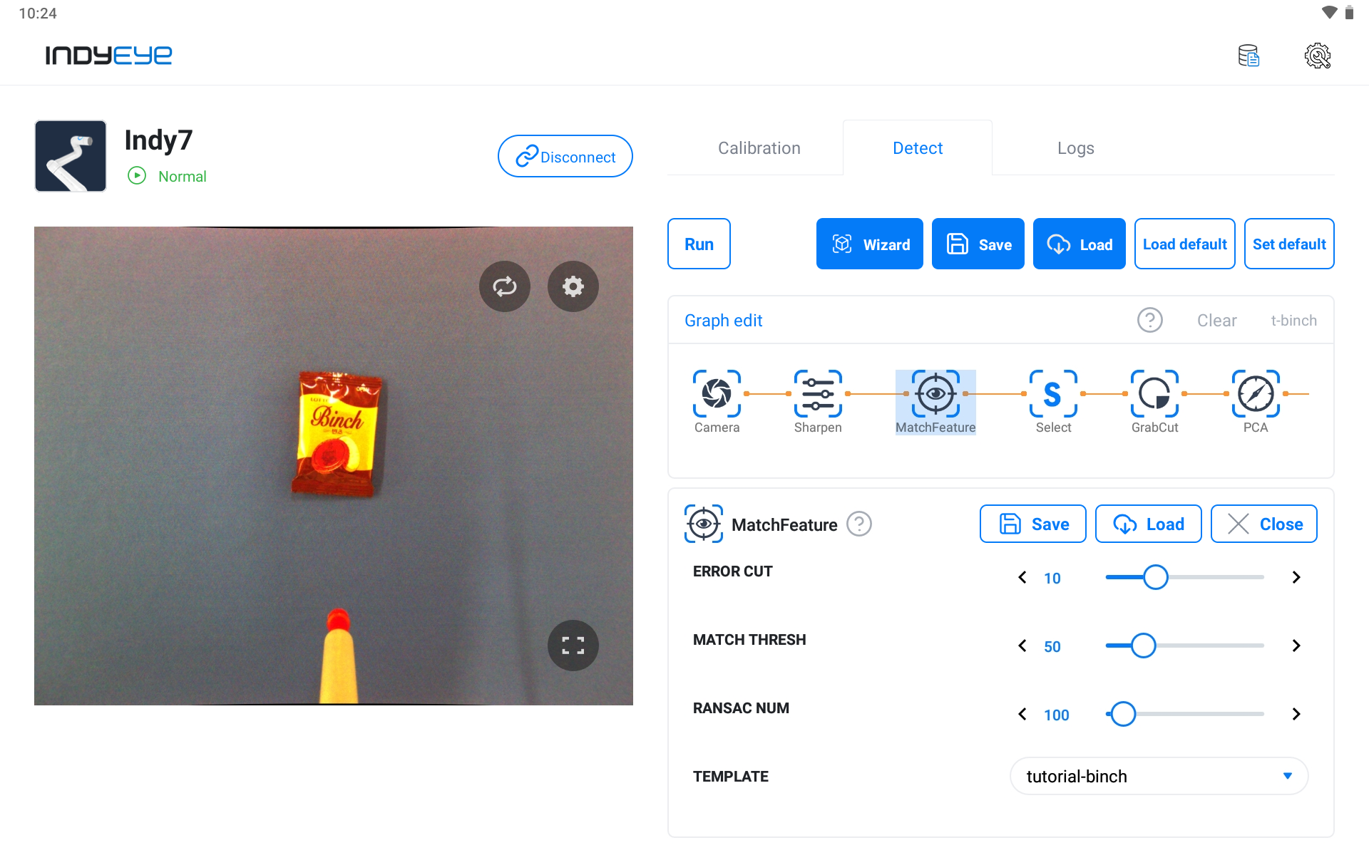

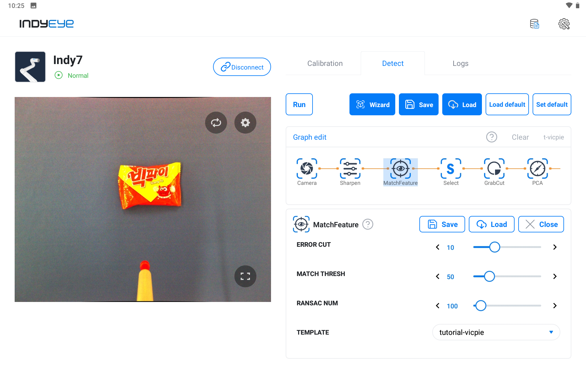

After entering the detailed settings of MatchFeature among the completed graph modules, select the name you entered when saving the image from the TEMPLATE drop-down item.
MatchFeature module settings

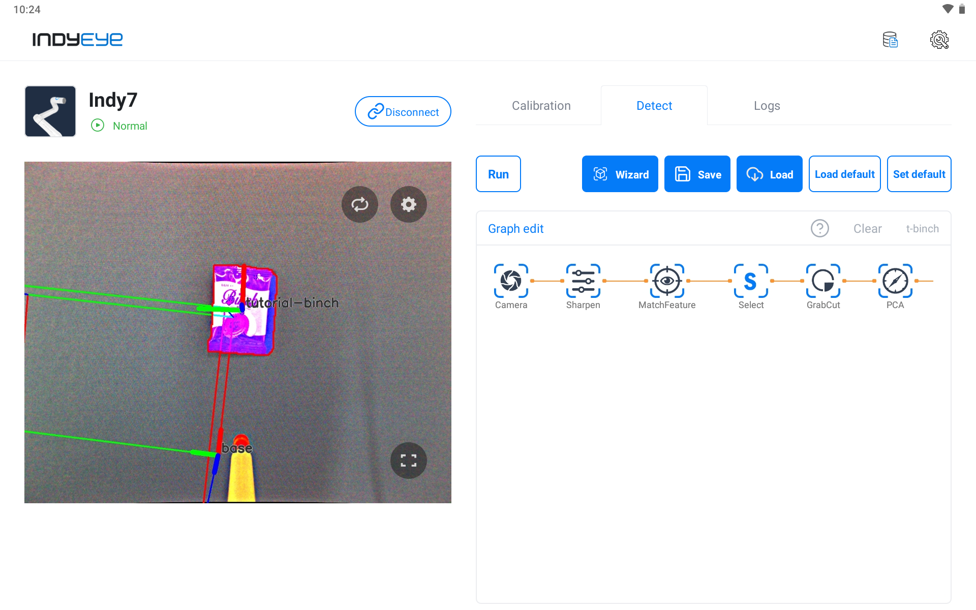

After completing the above steps, you can check the object recognition result by pressing the Execute button. If the recognition result is normal, save the graph.
First specimen recognition result

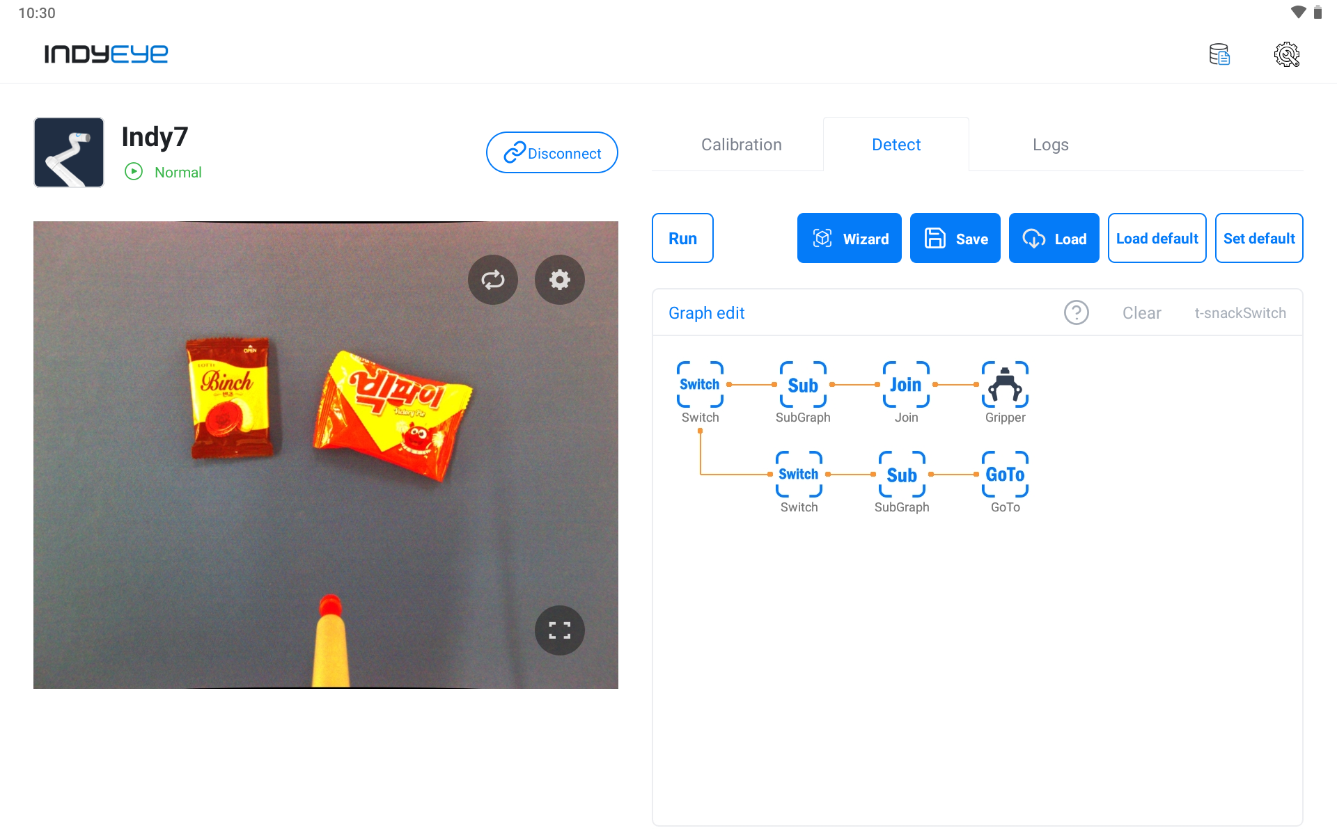

After saving the object recognition graphs for both specimens, we are now ready to go through the pick and place process. First, to initialize the current graph, press the Empty button in the graph window, and click Modify graph to configure the graph as shown below.
Pick and place graph composition
For reference, if you proceed with the wizard with the gripper instead of the gripper not used in the previously saved graph, you can also pick and place work on a single object. This example describes the pick-and-place process for various specimens, and single-object pick-and-place operations can also be performed with reference to the Conty settings described later.

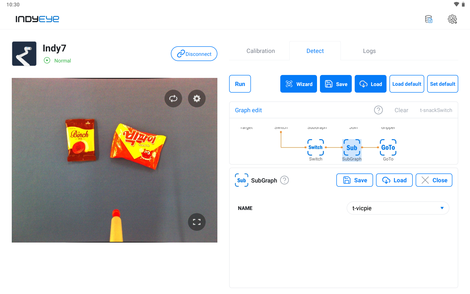

The first target placed on the graph is a test module that specifies the object to be recognized. After testing, it must be deleted when interlocking with Conty, and it must be changed to recognize the object specified by Conty. First, select the graph saved in the NAME item of the two SubGraphs of the configured graph.
SubGraph module composition

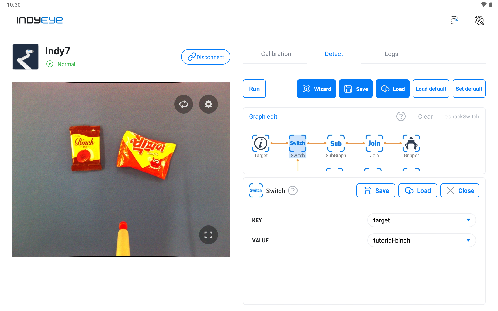

Next, the two Switch modules also select KEY as the target and VALUE as two specimens. That is, when interlocking with Conty, it is composed only of Switch without Target, and when interlocking, it operates as a general switch structure.
Switch module composition

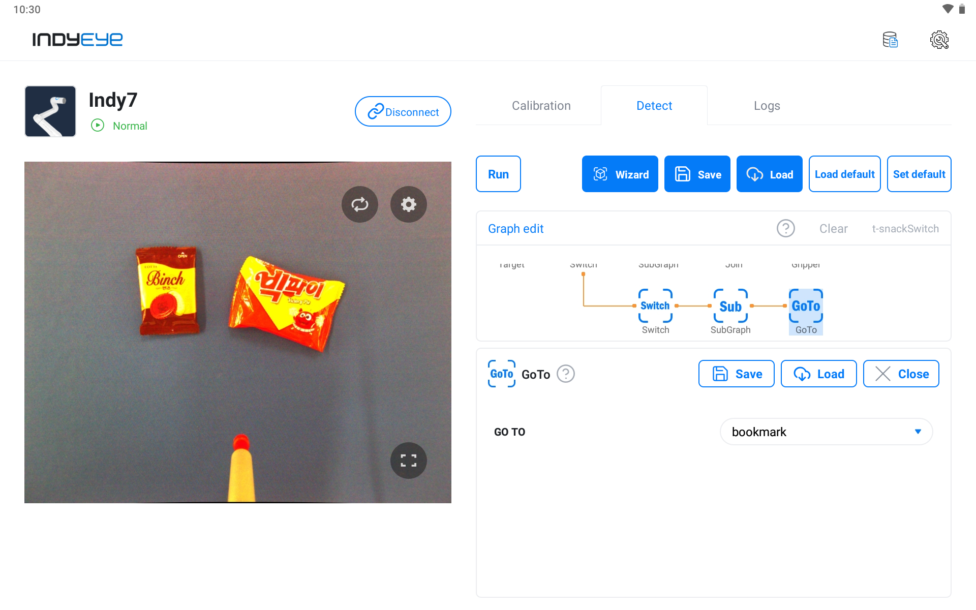

The GoTo- module in the graph leads to Join, and after recognizing each specimen, all go to the Gripper module to perform the pick operation.
Join module composition
GoTo module composition

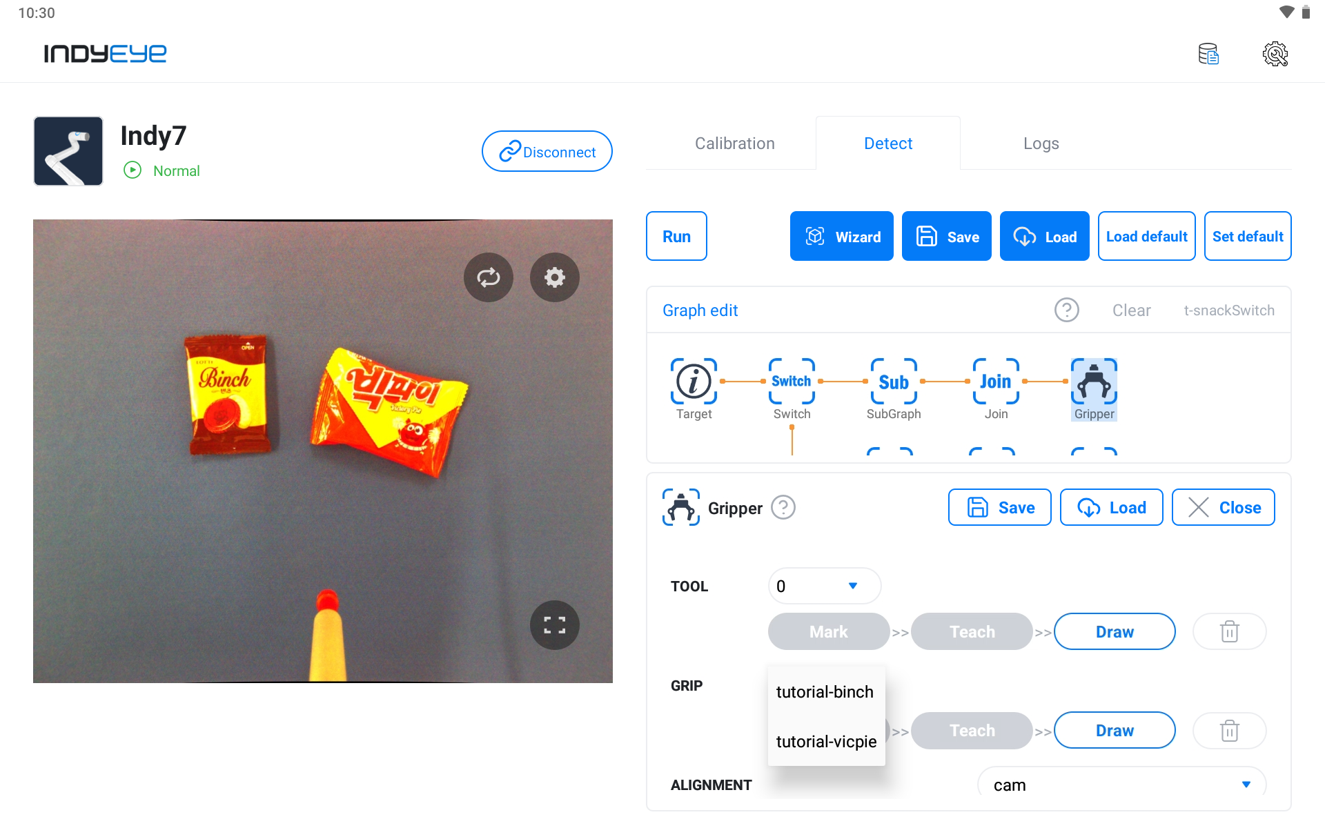

After the above settings, set the Gripper module. In this example, the object is gripped using a vacuum gripper. The robot can be equipped with various tools with IndyEye, and once installed, the tool position and gripping position must be set through the Gripper module. For how to do this, refer to the Gripper module setting in the graph module list and set the tool position and gripping position.

After completing the Gripper module setup, a list of specimens appears in the GRIP item as shown in the figure below, and you can check the recognition result by selecting the desired specimen from the first Target module.
Gripper module composition

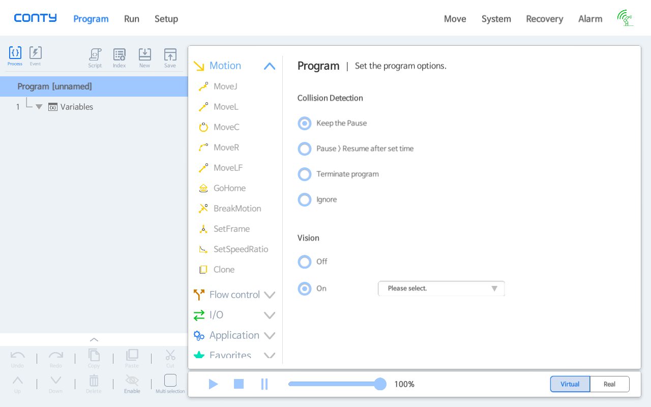

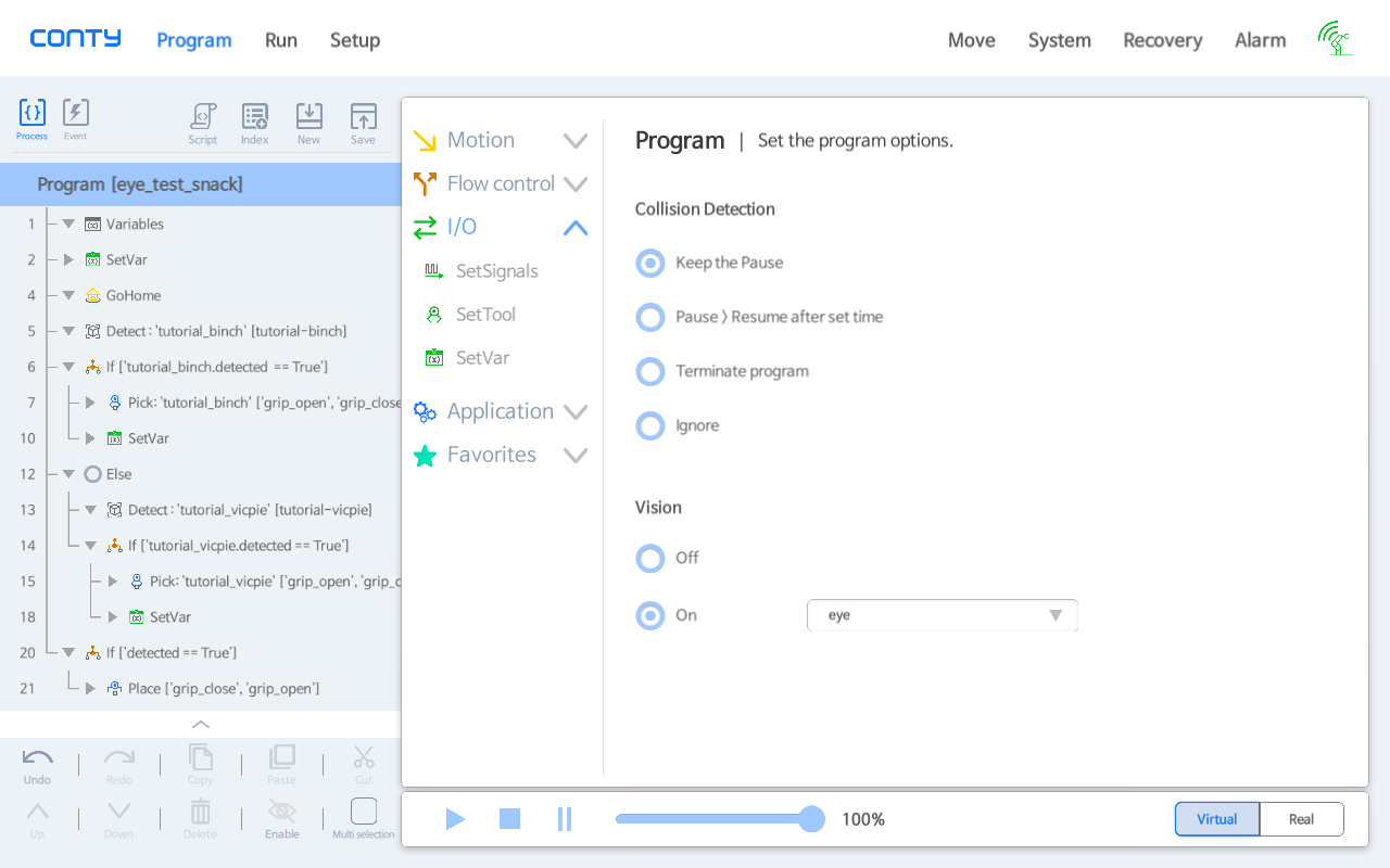

Prior to detailed description, when all Conty settings are completed, the program tree is completed as shown below. You can configure Conty's program tree by selecting Programs-New from the top menu.
Final Conty Program

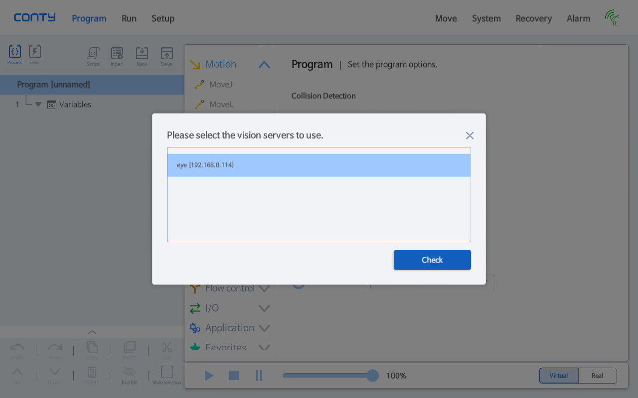

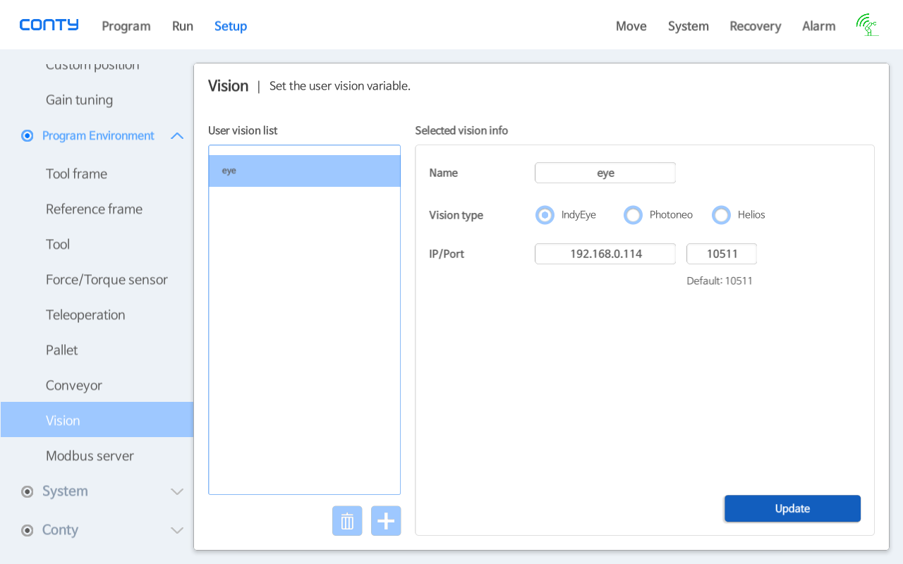

When entering the program tree, first, set the vision in the configuration as shown below for interworking with IndyEye. Select Edit Vision Settings, enter the desired name, and enter the IndyEye IP and Port(2002). Then Select IndyEye and add it.
  • If you have a separate IndyEye PC, enter the IP address of the separate PC. This IP is the same one that you enter on the first screen of the IndyEye APP.
  • If you are using IndyEye-LITE, enter the IP address of the IndyCB. This IP is the same one that you enter on the first screen of the IndyEye APP.
  • If you have an IndyEye CB produced in 2023 or earlier, check if your IndyCB have a camera port. In this case, your IndyEye processor and IndyCP have separate IP addresses internally. Enter 192.168.137.100.
  • If there is no camera port on IndyCB, you have IndyEye-LITE. (IndyEye-LITE: IndyCB-integrated version without separate address).
Vision Settings

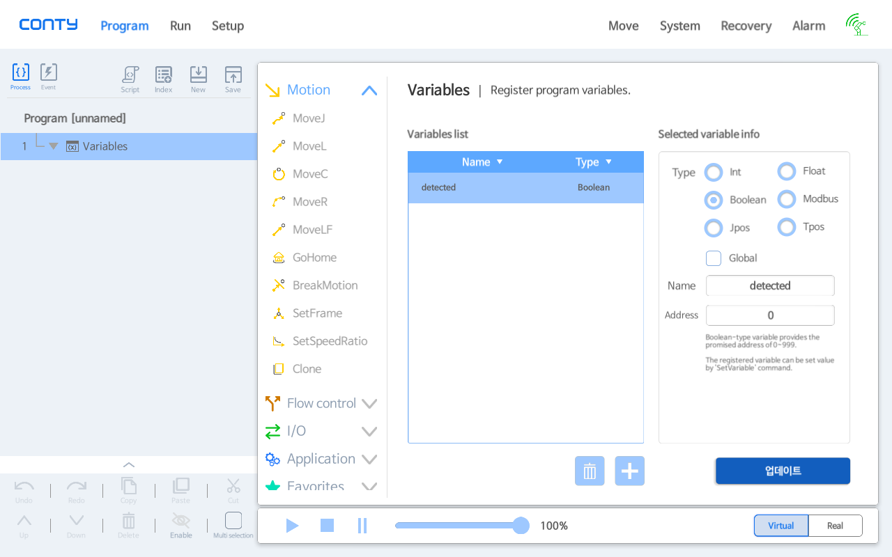

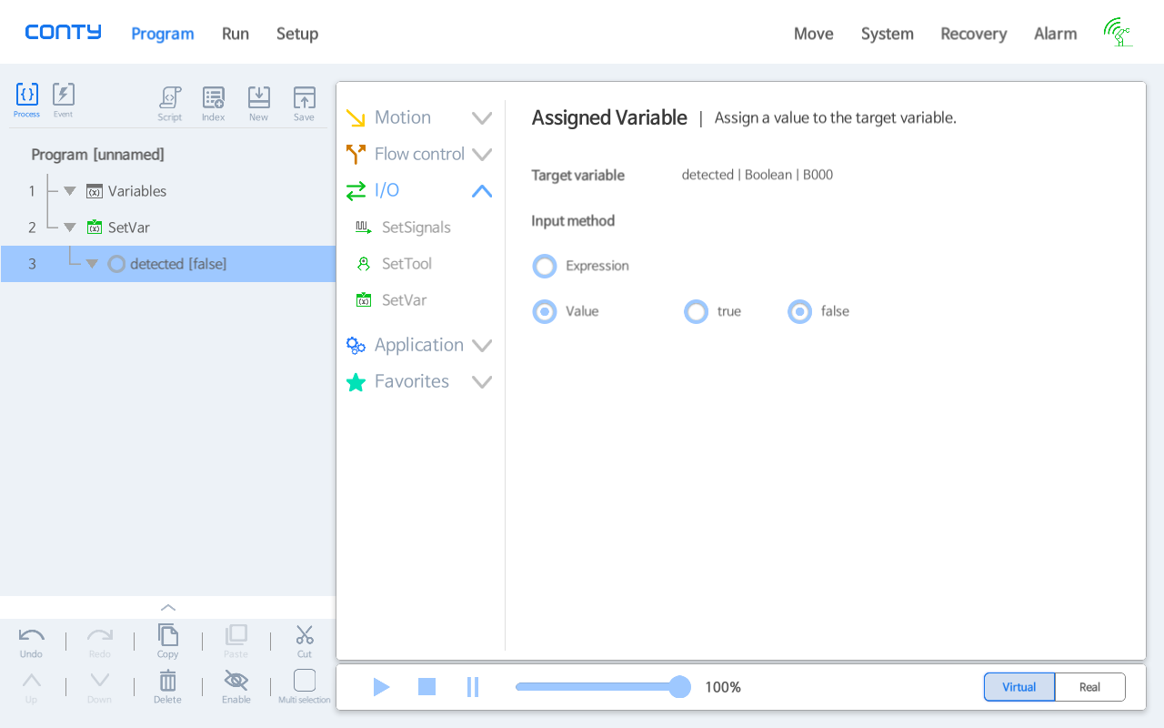

Next, in Variables, set the detected variable as shown below. This is to specify the flag to start the place operation after performing the pick motion normally. Set the initial value to false with the SetVar command.
Variable settings

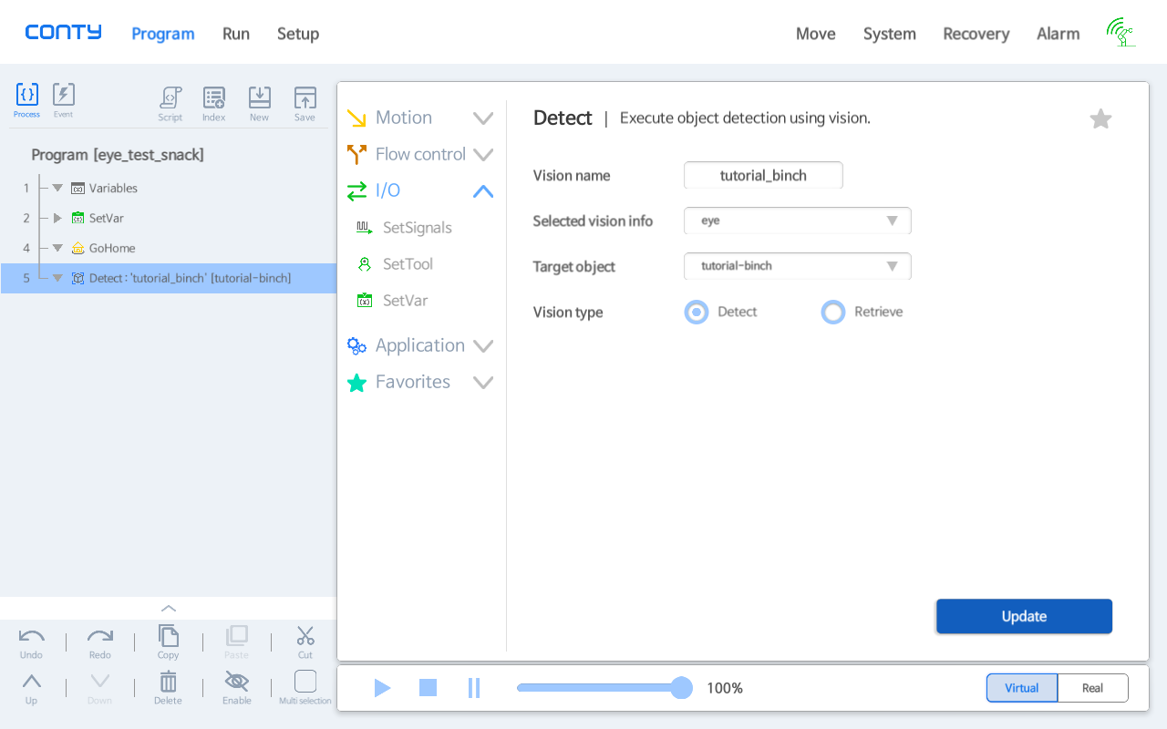

First, in order to try to recognize one of the two specimens, set the Detect command as shown below. Also, select the target object.
Detect command setting

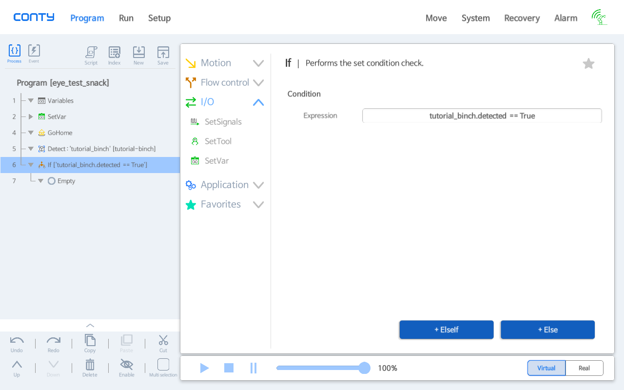

If the above target is recognized normally, we need to perform the pick operation, so add the If statement as shown below.
If command setting

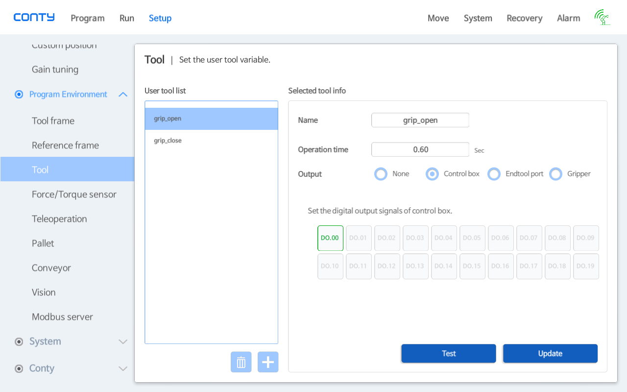

Before proceeding, the tool setting attached to the robot must be done in Conty first. After entering the tool setting of the robot setting, add the tool to the user tool list. Set the output according to the operation method of the currently installed tool (such as using I/O or end tool port). For detailed instructions on connecting and setting up the tool, please refer to the Indy manual provided with the purchase.
Tool setting

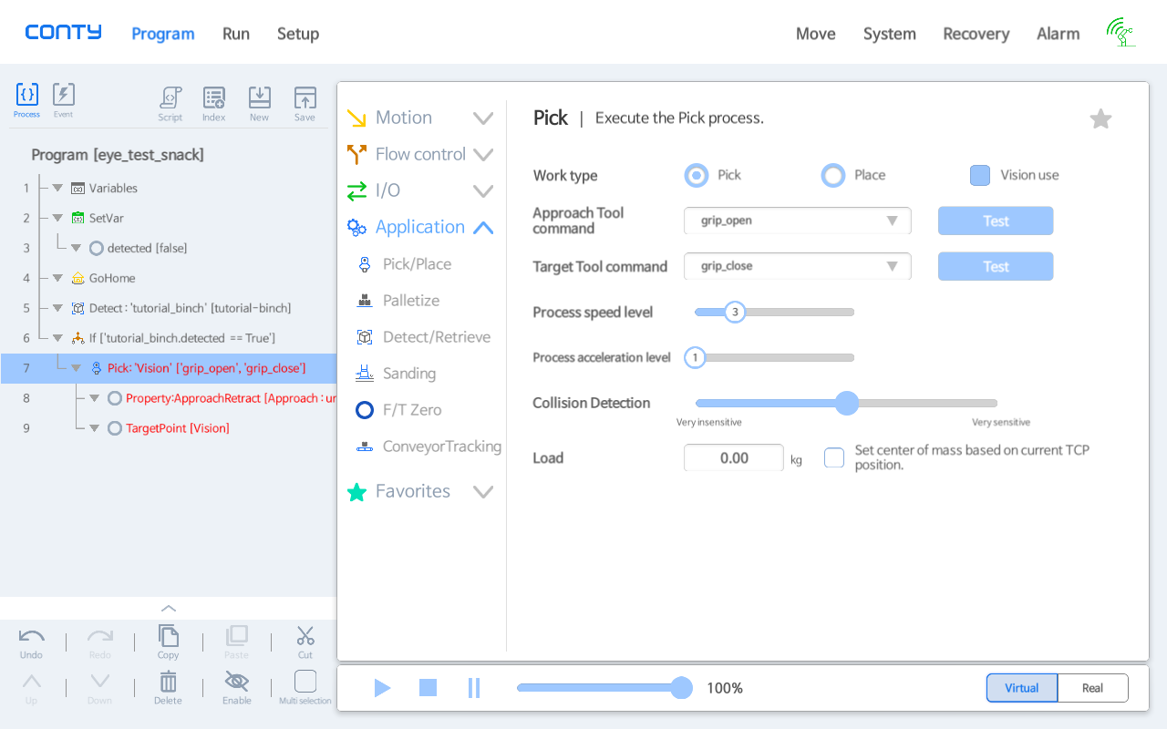

After setting the tool, add the Pick and SetVar commands to the sub-tree of the If command previously added, and touch the added Pick command.
Pick Edit menu

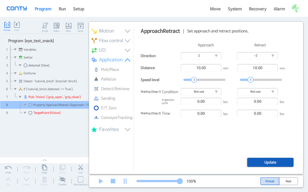

First, assign the added tools to the Approach and Target Tool command on the top, and select Use Vision.
Then in the Property:ApproachRetract, enter the travel direction and distance. The direction and distance are to set the approach/retraction motion before and after picking, and you must enter a value. For other settings, set the value as desired by the user.
Distance/Direction setting

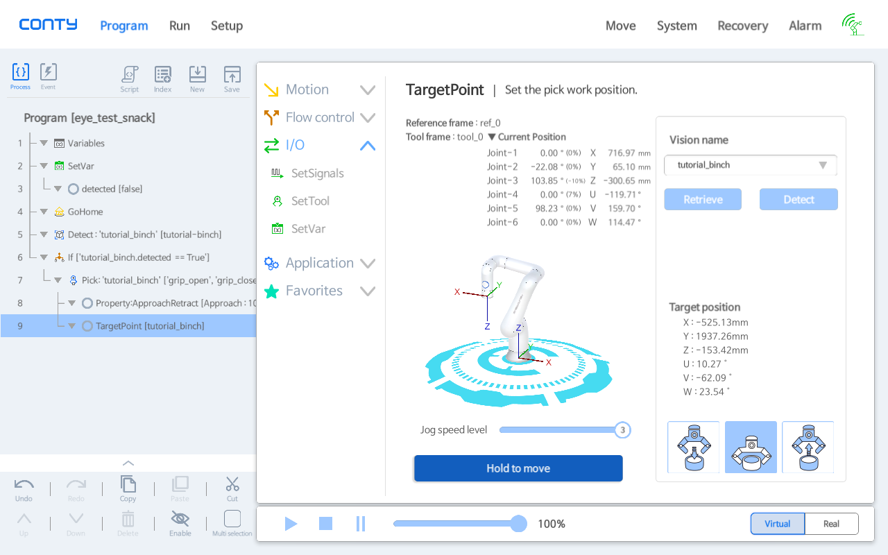

After setting the distance/direction values, go to the TargetPoint and assign the first specimen to the Vision name.
Vision target setting

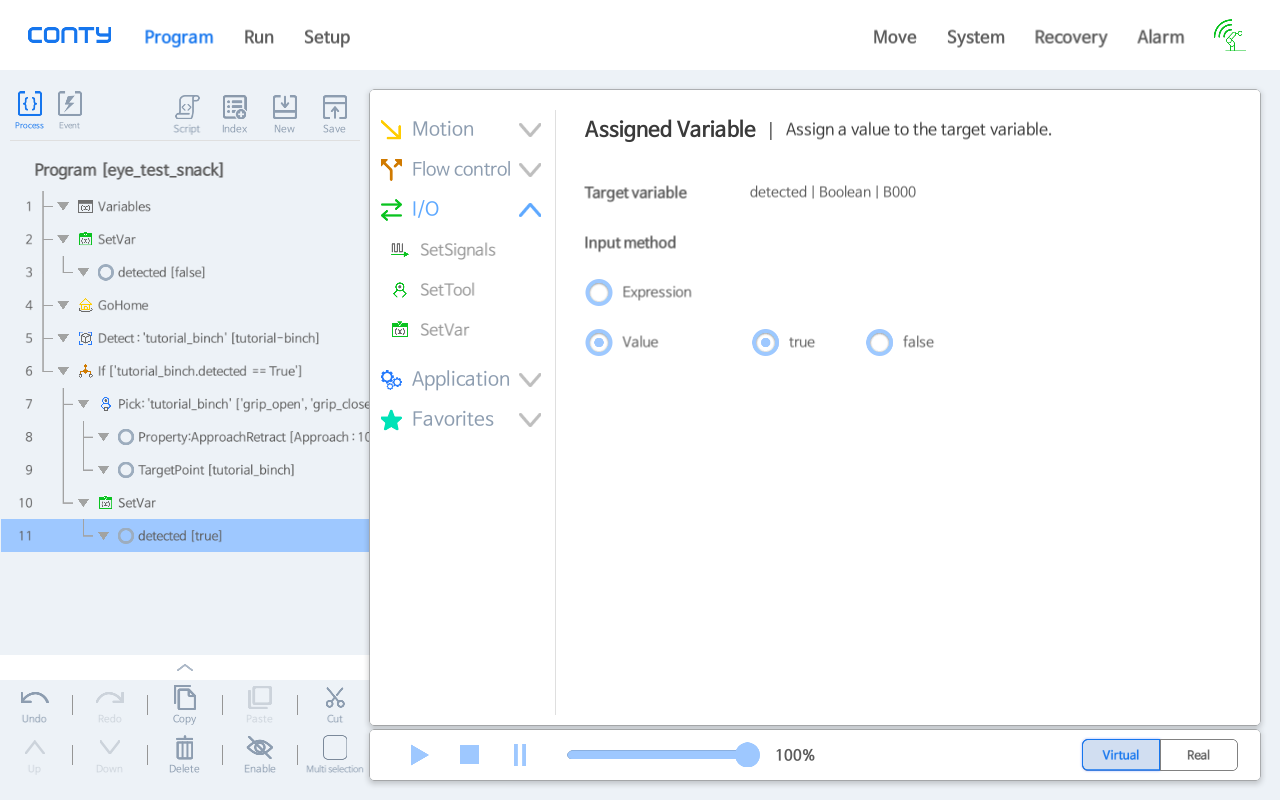

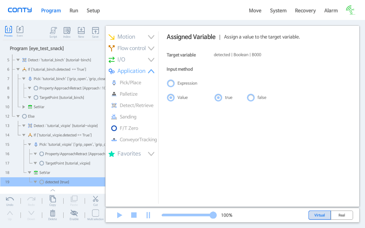

When all settings are completed, change the detected variable to true in the SetVar added with Pick and save it. It acts as a flag to complete the pick operation.
SetVar setting
If the first specimen is not recognized properly, or if you place the job after recognition, add the Else command and the Detect command as a subtree to recognize the second specimen. In the Detect command, set the second specimen as the target object, and under the If command, Pick and SetVar are added in the same way as the first specimen. At this time, the setting for Pick Edit is the same as the previous method.
Second specimen pick operation setup

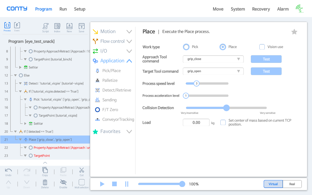

Up to the process above, the Conty settings for the pick operation has been completed. Now let's set up the place to work. As in the If and Else commands added earlier, add the If command as shown below. To that subtree, add a Pick/Place command and change the work type to Place.
Place command settings

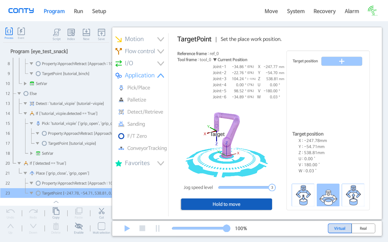

After that, set the final place position to the TargetPoint. After assigning the final location, select Property:ApproachRetract. As with the pick setting, set detailed settings such as the direction and distance of movement to the desired values.
Place setting
