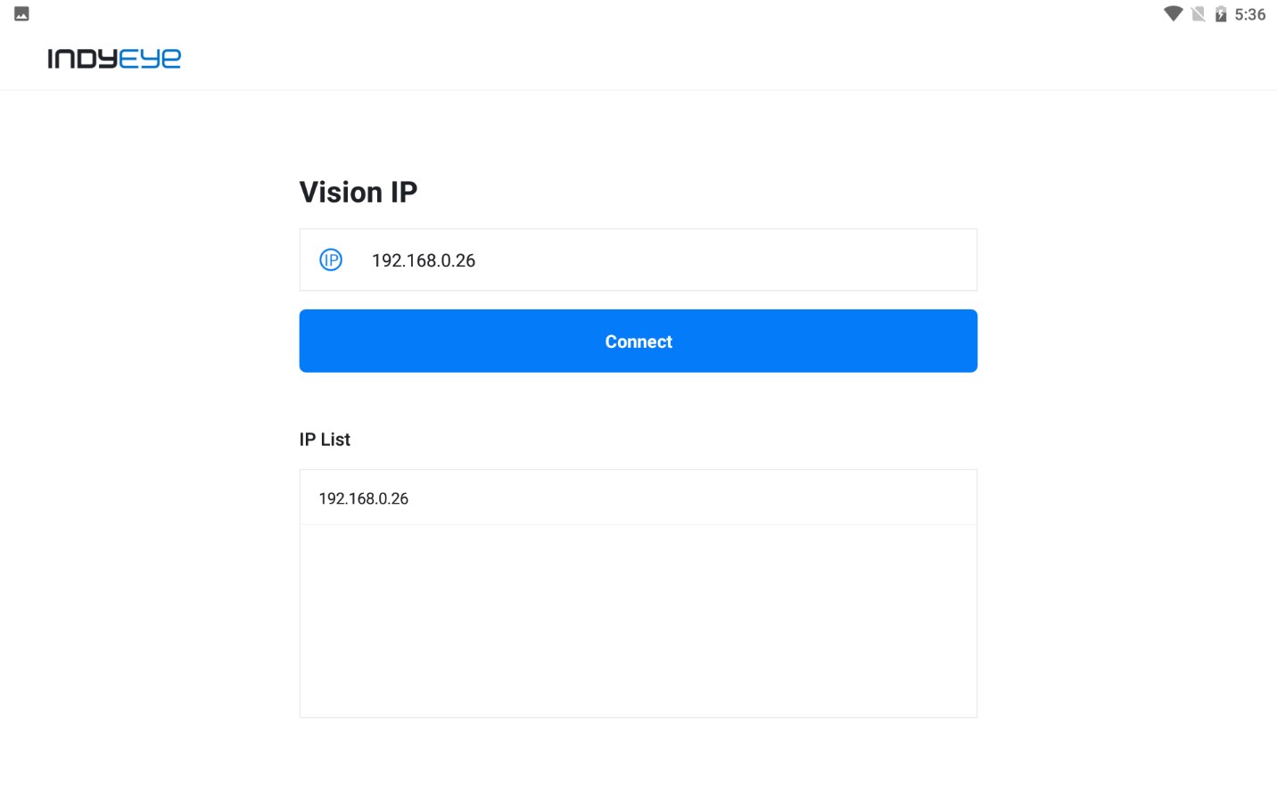

After the installation is complete, turn on the power of the IndyCB to operate the robot. A dedicated app is used for IndyEye settings. Connect by entering the IndyEye IP address on the main screen of the installed IndyEye app.
  • Separate IndyEye: Use the IP of the provided separate PC. The network name is "indyeye."
  • IndyEye-LITE: Use the IP of the IndyCB. The network name is "STEP-TP."
  • (Prior to 2023) IndyEye built-in IndyCB: Use the IP of the IndyCB. The network name is "STEP-TP."
You can search for the IP corresponding to the network name mentioned above using an IP scan tool (Advanced IP Scanner). Enter the searched IP in the Vision IP field as shown in the image above and click the Connect button. In the IP list, you can check the recent connection history.

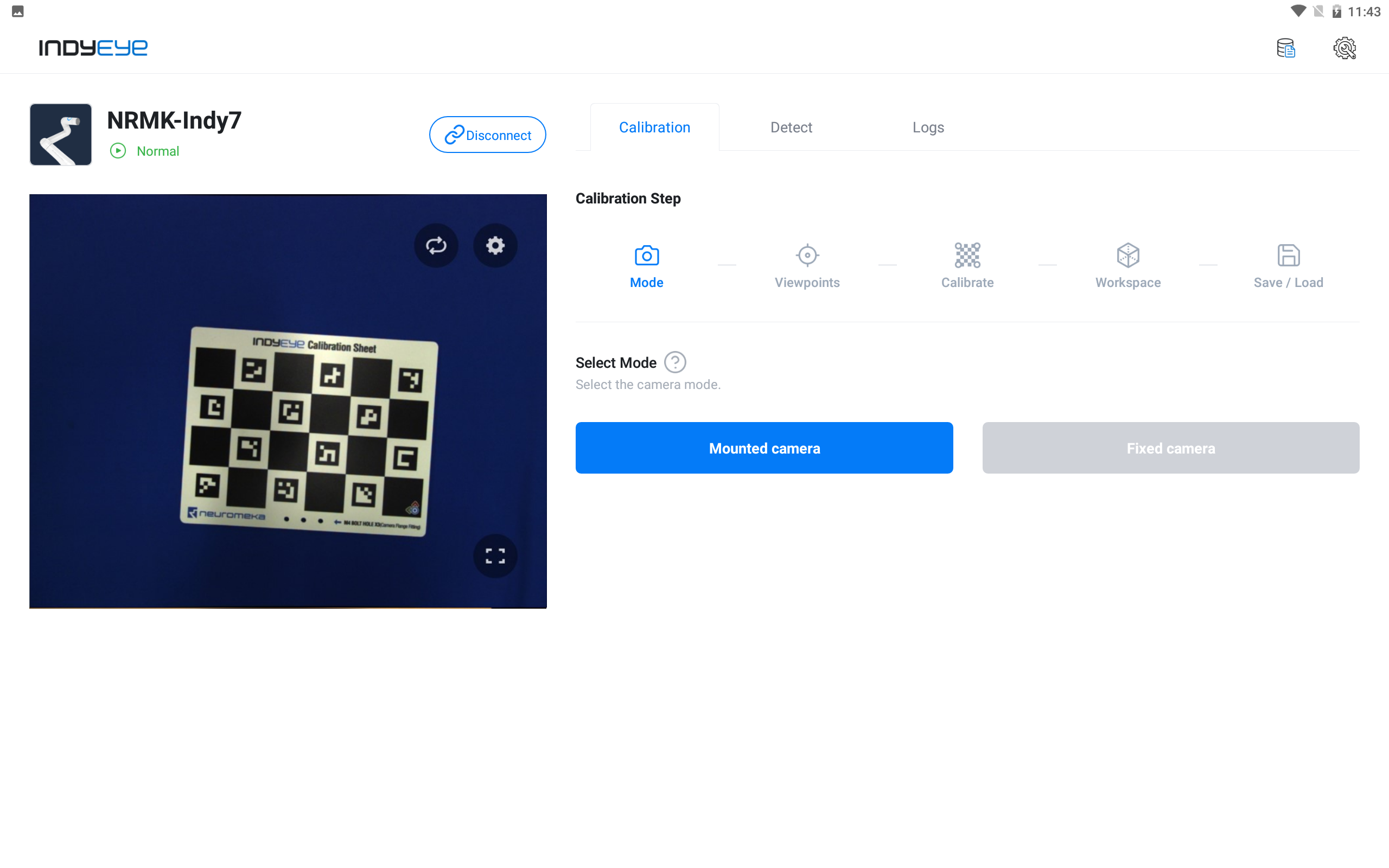

Calibration of IndyEye can be done using the supplied calibration sheets captured in various directions. Place the calibration sheet on a surface as shown in the figure below. Select the appropriate mode from the Calibration Modes.
  • Mounted Camera is used when the camera is mounted on the robot.
  • Fixed Camera is used when the camera is installed in a fixed location.
Calibration Tab

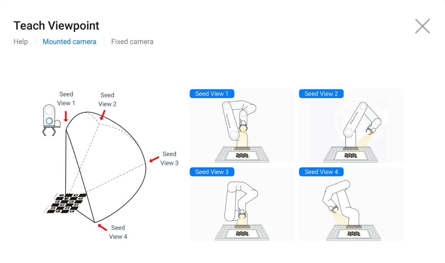

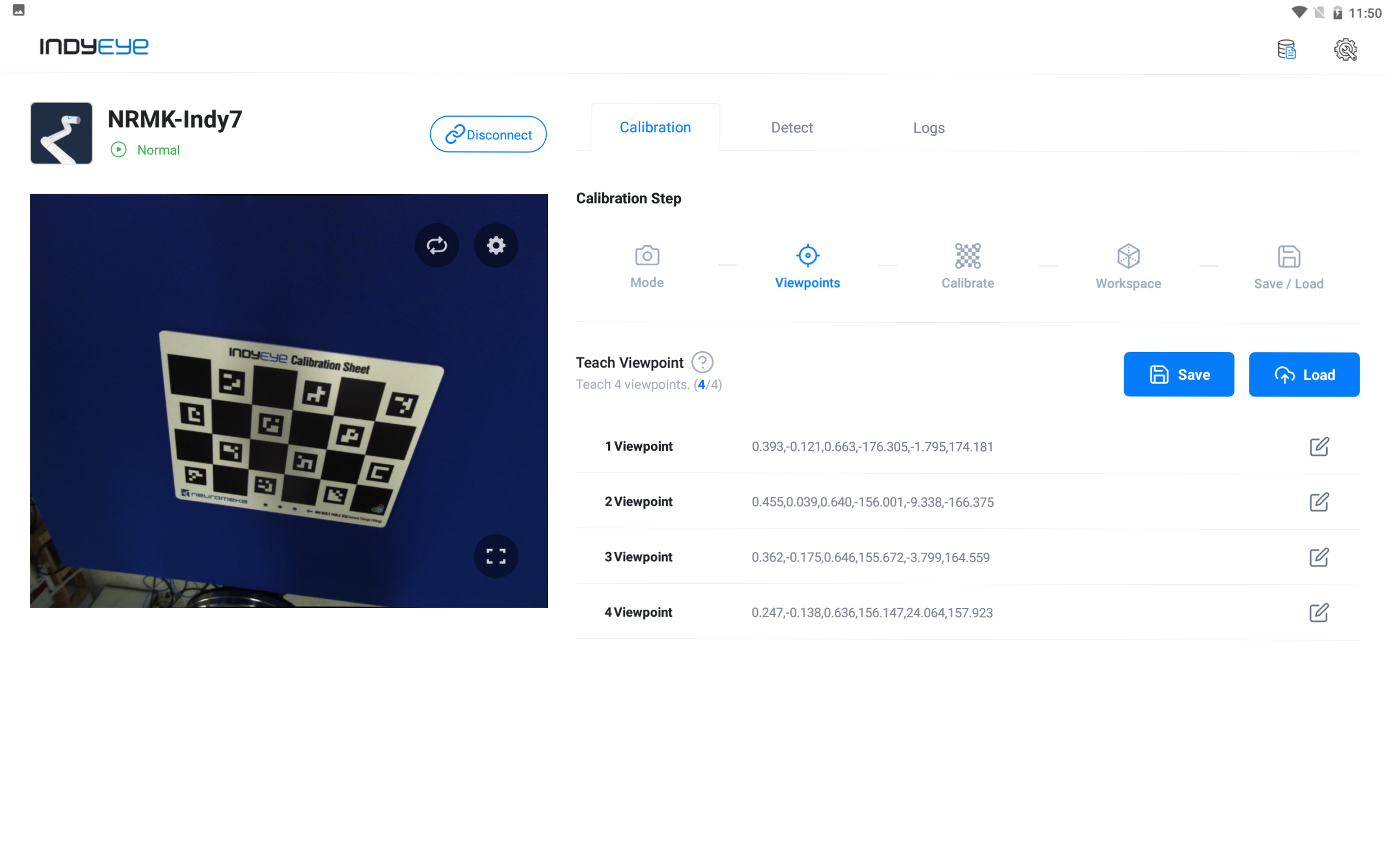

Next, click the Viewpoints tab and proceed to Base Viewpoint Teaching in order to define the robot’s movement range. Like below, move the robot to base viewpoint and click the ‘Write’ icon to save. You can use direct teaching mode or Conty to move the robot, which were explained previously. After teaching, other defined viewpoints can be saved and loaded upon further calibration procedures by using the Save and Load button. Following the teaching method below, the last joint is adjusted to place the calibration sheet at the center of the app screen.
Warning
During teaching viewpoint 2 and 4, adjust axis 6 of the robot to equalize the screen’s horizontal and vertical axis to the calibration sheet. Also, adjust the distance between IndyEye and the sheet to make the sheet take over 1/3 of the screen before calibration.
Caution when using a robot with the manual/auto mode
If the robot you are using has manual mode/automatic mode, you must change it to manual mode when teaching viewpoints and automatic mode when calibrating for proper operation.
Teaching of Seed Views
Teaching of Seed Views completed

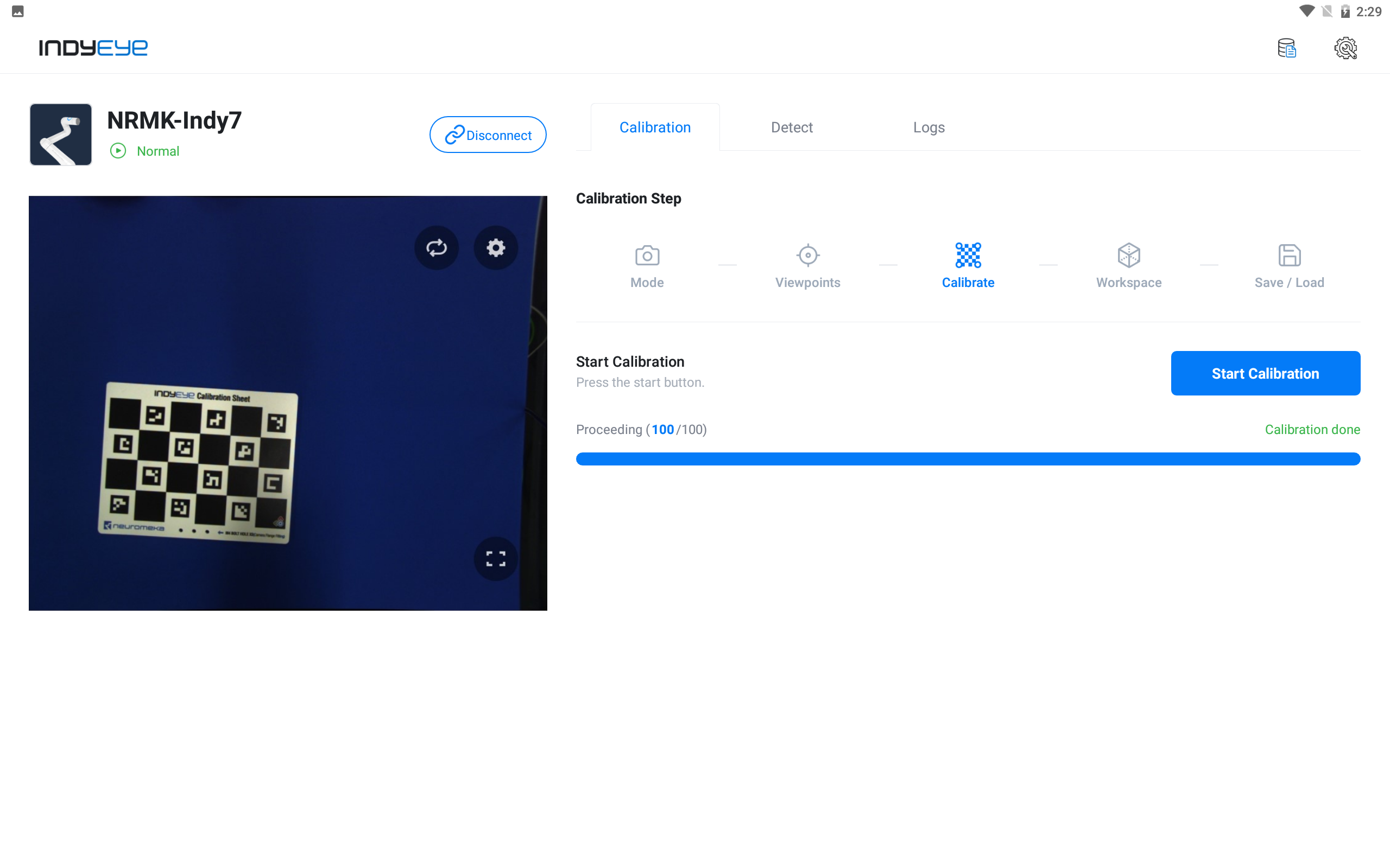

Next, in the calibration tab, click Start Calibration, and the button will change to Stop Calibration. The robot will automatically move and take pictures of the calibration sheet. It alternates between taking pictures and performing calibration calculations, and the robot may be stationary during the calibration calculations. The entire process takes about 2 to 5 minutes, and when it is completed, a message saying Calibration Complete will be displayed.
Calibration done

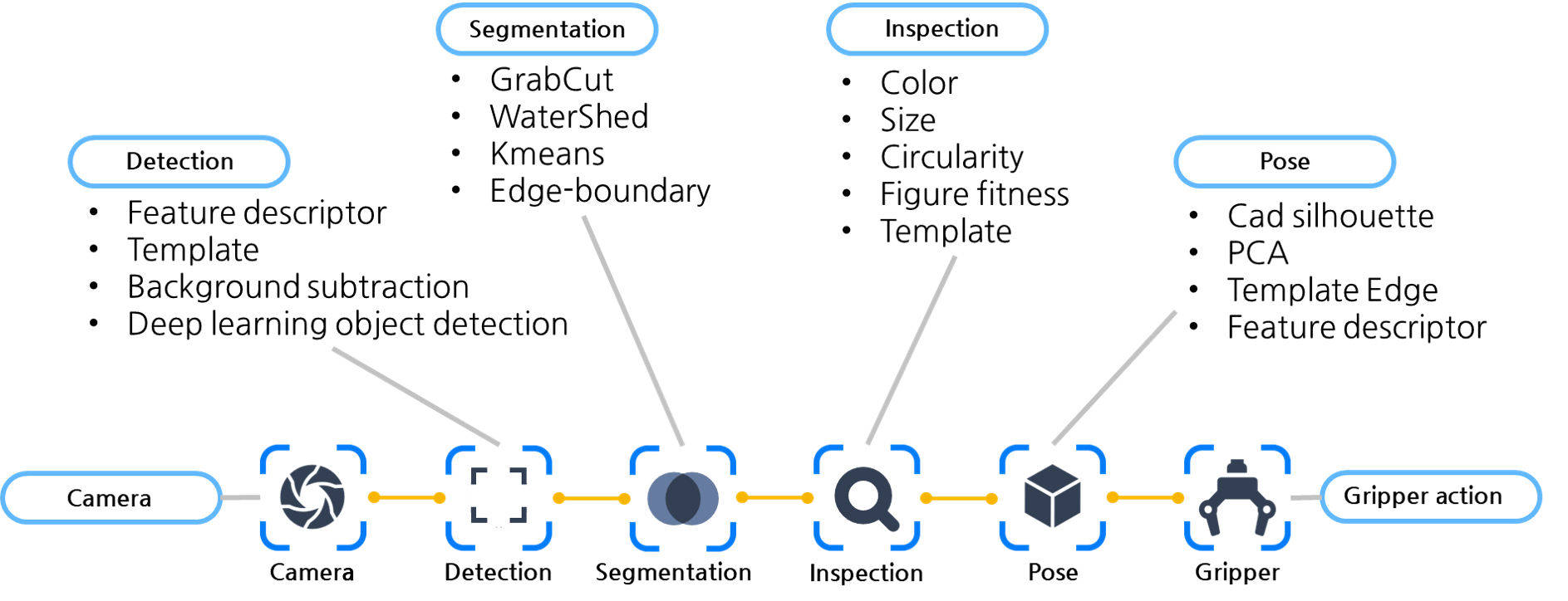

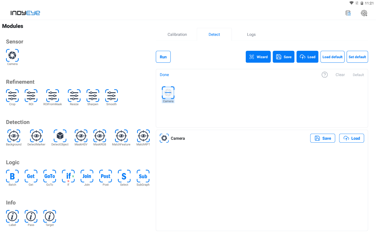

Object detection can be performed in the Detection tab with use of the Graph module, setting the detection algorithm. The basic structure is composed of an input sensor (Camera), Detection, Segmentation, Inspection, Pose and Action (i.e. gripper movement). The detection algorithm can be edited by adding and modifying each module. By clicking Modify Graph from the detection tab, all the available modules can be checked. A detailed description of each graph module can be found by clicking on the graph module list Graph Modules List or at the help icon inside the IndyEye app. Basic usage of the graph module will be introduced below through a simple detection example.
Add Camera Module

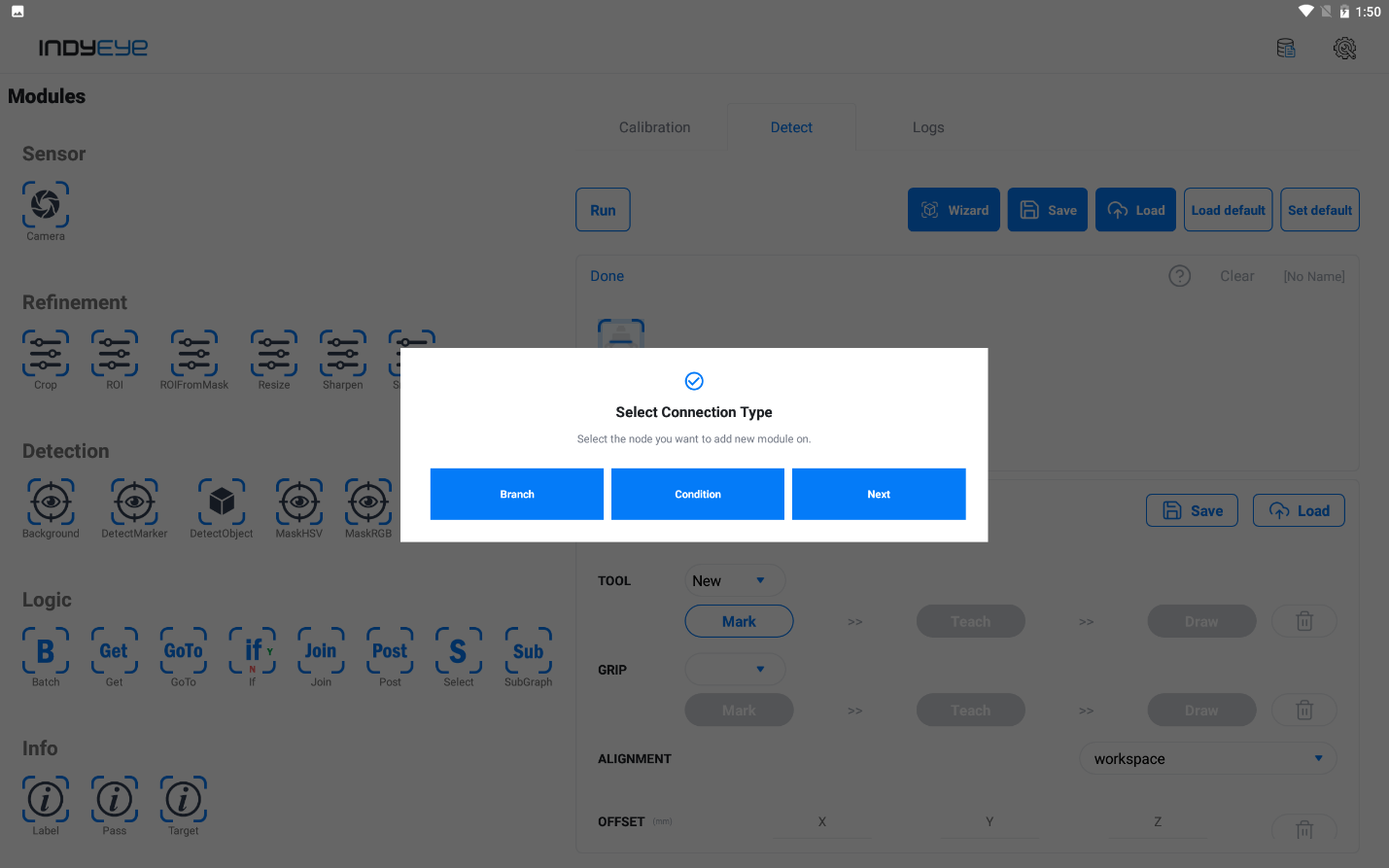

To start editing the graph, press the Graph edit button. Then the Camera module is selected as the Sensor being used. It’s possible to add a module by using drag and drop or clicking on the module to make the window below appear. Then, add DetectMarker from the Detection class. It can be added by either drag and drop or clicking the module and the window shown below.
Selection of Connection Type
Next will add the module right after the previous module, Branch is used together with Switch statements and will add the module below the previous module. Condition will add a module above the previous module and will only be invoked if a condition is matched. In this (simple) example only the Next button will be used. No Refinement will be used, for Detection the DetectMarker option is chosen.

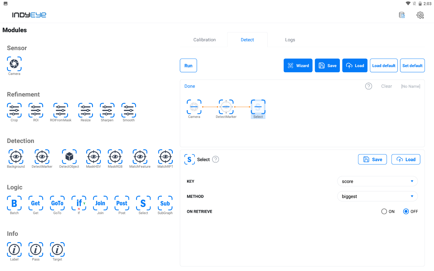

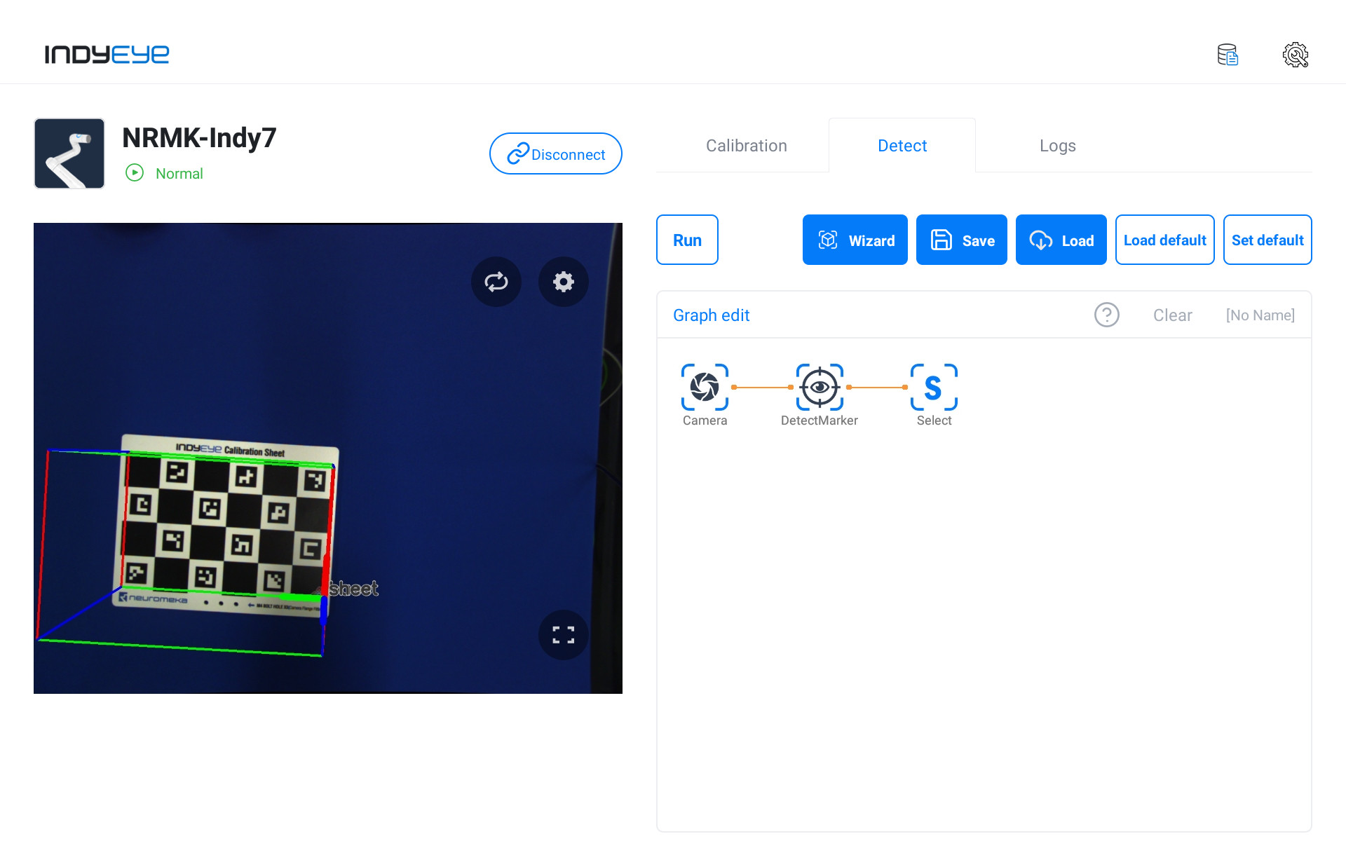

From the Logic class the Select module is added to the graph, which is necessary after the Detection class module. DetectMarker will detect any objects recognized as markers, with Select being the best match that can be selected. Within the Select module settings, the KEY selected is the score combined with the largest METHOD, meaning the object with the best match will be chosen.
When configuring each module, you can Save and Load its settings using the Save and Load buttons at the top of the module settings.
After completing the graph configuration as shown in the image below, click Save at the top of the graph to save all settings at once. You can click Load to load previously saved graph configurations.
Click Set default or Load default to apply default settings.

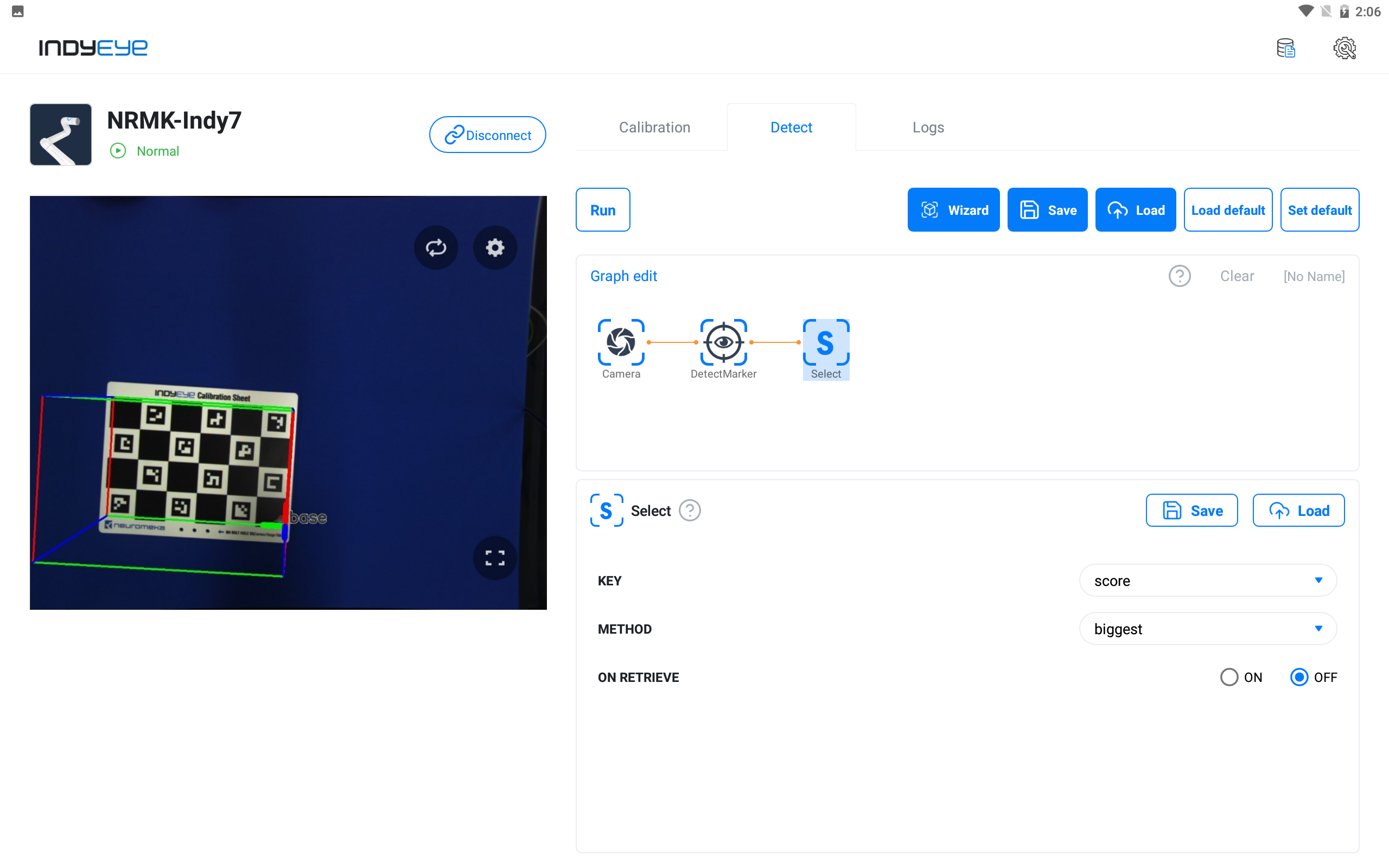

Completed Graph
Once completed, click the Run button to execute the algorithm. As expected, the sheet is recognized as the closest match for the detection through DetectMarker.
Sheet recognition results
