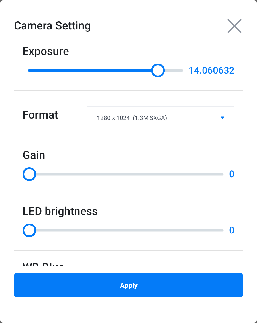

After accessing the IndyEye app, press the settings button on the upper right of the camera screen to bring up the camera settings pop-up. Adjust the settings in the pop-up and press the Apply button to change the camera settings.
The possible values that can appear in the Camera Settings pop-up are as follows. The values that can be set may vary depending on the type of camera connected.
| Value name | Description |
| Exposure | Camera exposure value |
| Gain | Camera signal gain |
| WB Red, Green, Blue | Camera white balance value (R, G, B) |
| Format | Camera image format |
| LED brightness | Robot end-tool camera LED brightness setting This is available only when a robot is connected, and is supported only if the robot end-tool camera's LED is an auto-adjusting model. |
| Auto balance | Toggle automatic brightness adjustment function |
| Trigger mode | Toggles Camera trigger mode Default: True (Trigger mode enabled) This setting selects the camera shooting method from trigger mode (takes pictures only when necessary) or live mode (always shoots). |
| Undistort | Toggles camera undistortion feature |
