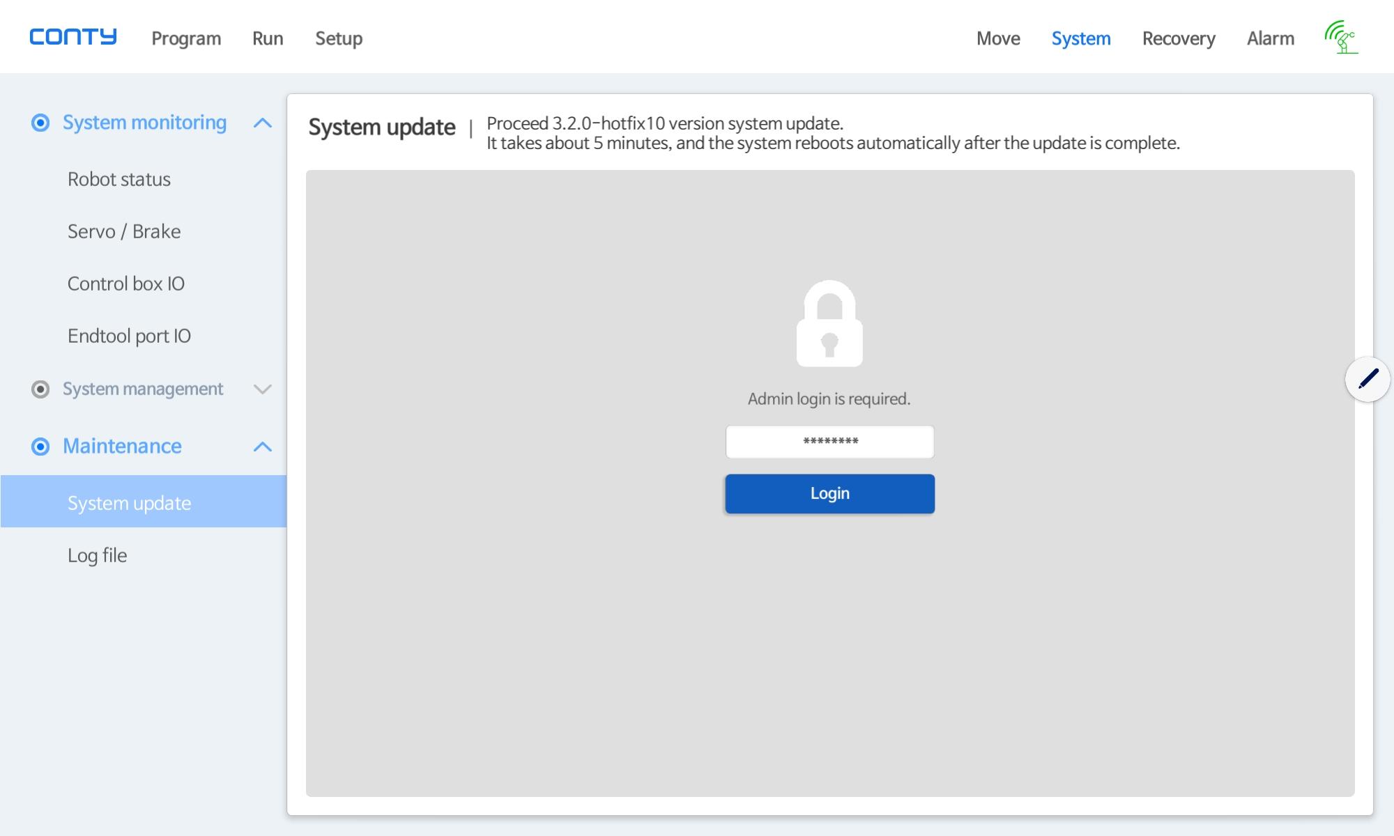

If you have already installed Conty version 3.x, software updates can be performed using Conty. After connecting to the robot through Conty, click on the 'System' tab located at the top and then click on Maintenance - System Update on the bottom left, a login screen will appear as shown below.
Enter Password

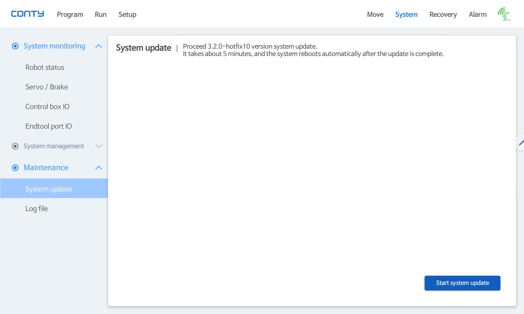

After entering the admin password and pressing the login button, the system update screen will appear, and pressing the Start System Update button on the bottom right and waiting will complete the software update.
System Update

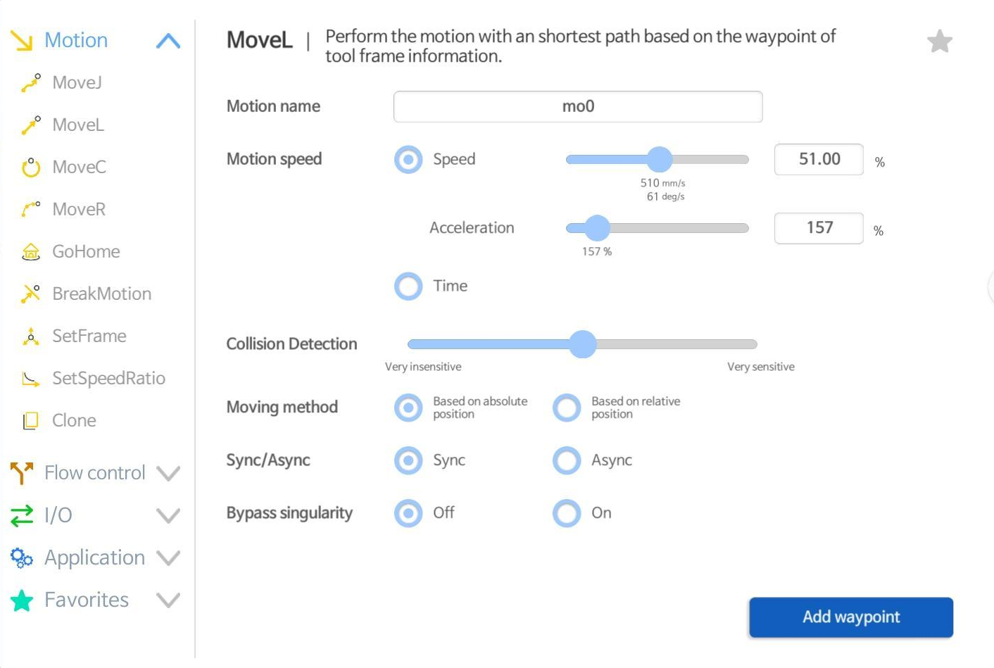

Conty provides Move functions for creating various robot motions.
Various Move functions in Conty
Each Move command allows you to adjust the speed of robot motion through speed/acceleration settings or time settings, and you can adjust collision detection sensitivity.
MoveJ
You can create motion in joint space.
MoveL
You can create motion in task space.

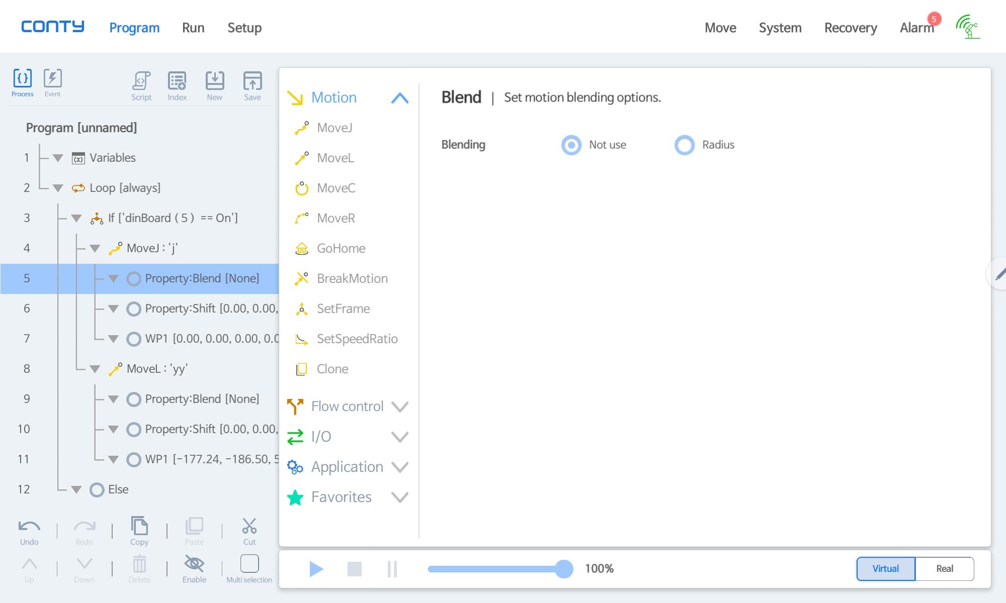

Programming Function
Programming features in Conty
Conty allows even non-experts to easily perform robot programming through a graphical user interface. The various motions mentioned earlier can be taught through direct teaching, jogging, etc. Flow control commands (conditional statements, loops, etc.) can be used to implement the robot's operational logic. Additionally, control of input/output devices, integration with external devices like PLCs and PCs, and internal variable functions make system integration easier.

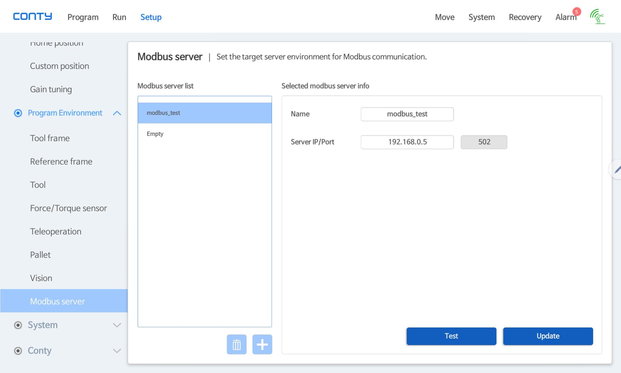

Modbus Function
Modbus server function in Conty
Conty allows you to use the Modbus server provided by the robot, as well as access the Modbus server of external devices (PLC) as a client.

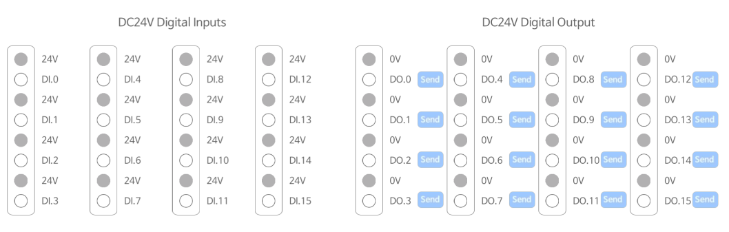

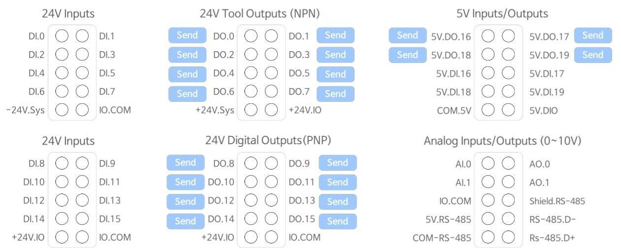

Input/Output Function
I/O Board Input/Output
"RevC" Version I/O board input/output function in Conty
"RevE" Version I/O board input/output function in Conty
You can control the digital and analog inputs/outputs of the I/O board mounted on the robot control box.
