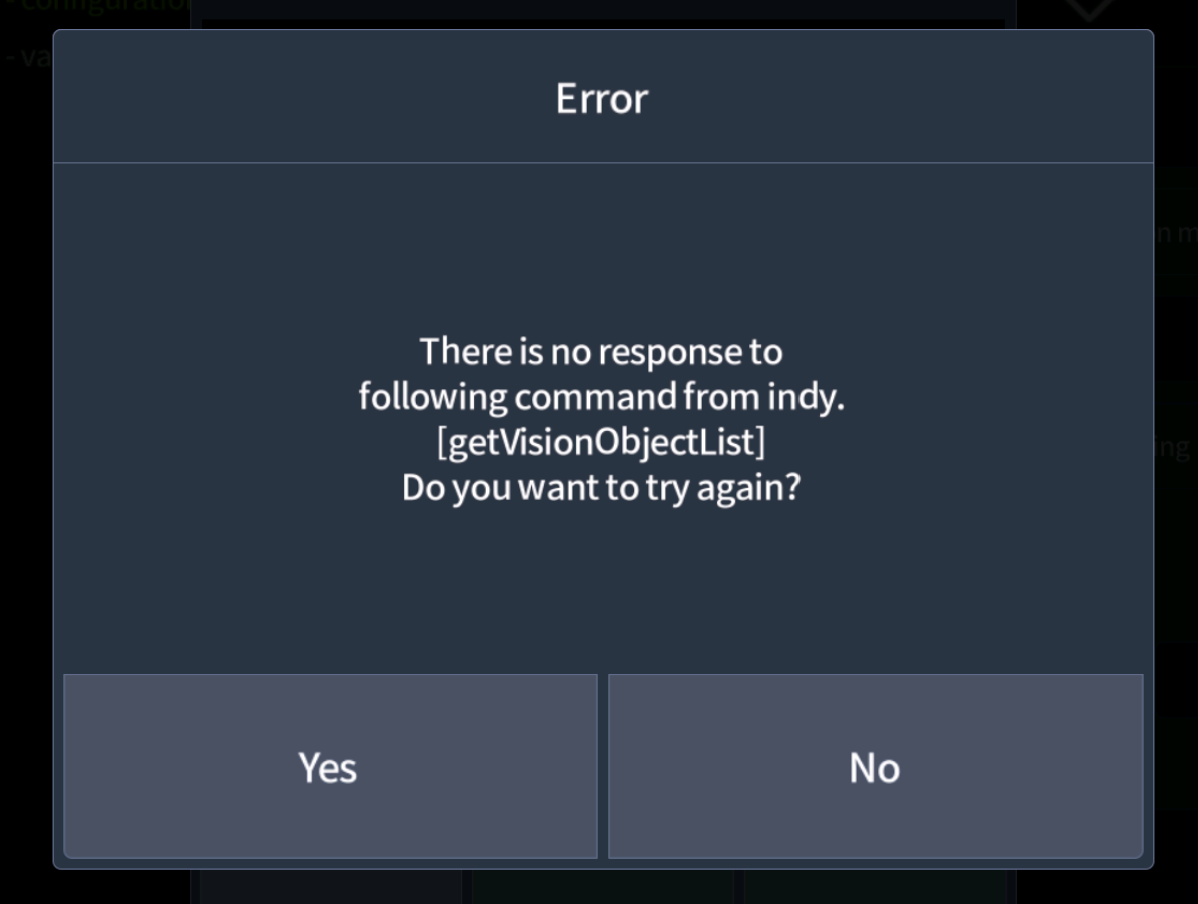

Error While Linking with Conty
Failure to respond to getVisionObjectList 2
- In Conty Version 2, attempts to connect to the wrong vision IP/Port can cause the error "no response to getVisionObjectList", and the Conty app may be disconnected from the robot.
- This error can be resolved by restarting the robot.
2 This only occurs in versions of Indy and Conty 2.4.5 and below
